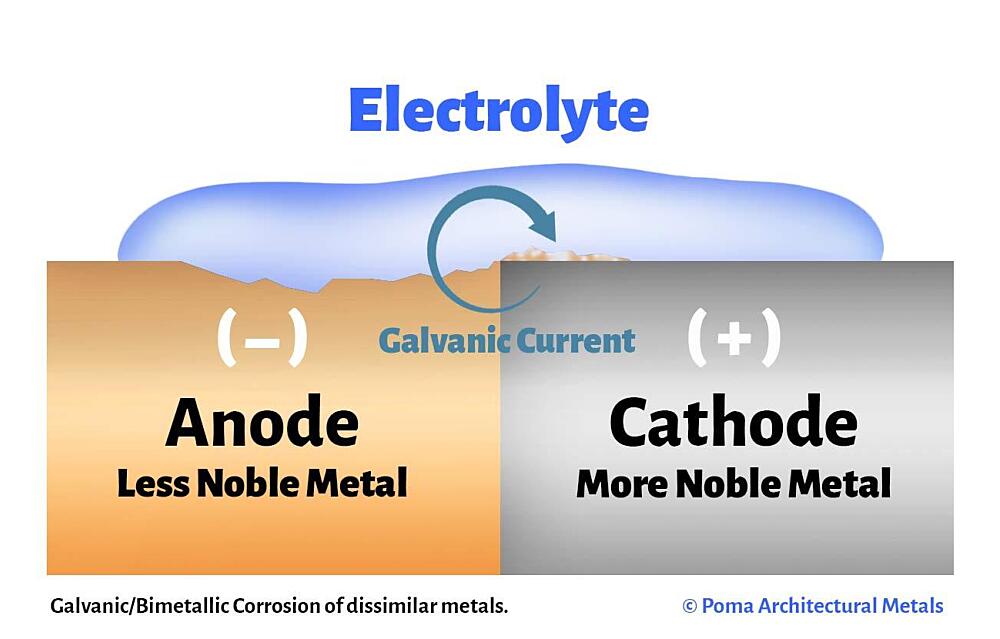

Galvanic/Bimetallic Corrosion of Dissimilar Metals Explained

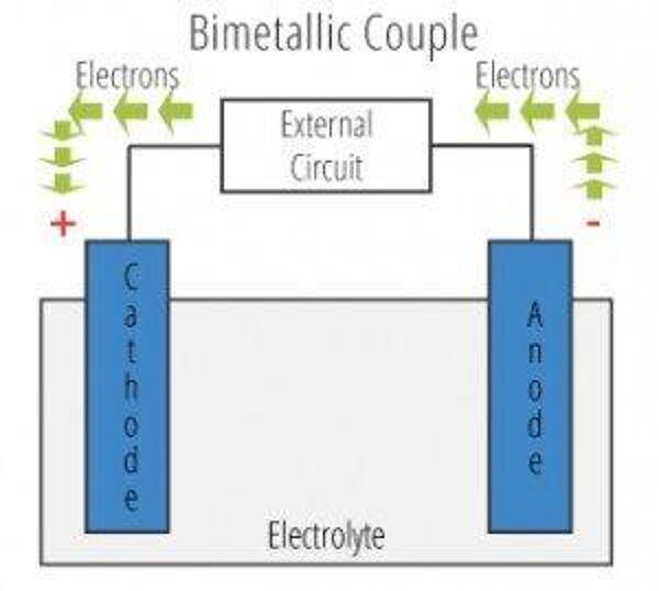

Galvanic Cell
The galvanic cell is similar to a battery, consisting of two dissimilar metals immersed in an electrolyte solution. An electrochemical reaction occurs involving a transfer of electrons from one metal to the other (electric current) when the two metals are connected by an external, conductive path. This results in accelerated corrosion of the metal losing electrons while the metal receiving electrons is preserved.
However, just because dissimilar metals are in contact does not mean galvanic corrosion will occur. The formation of a galvanic cell requires all the following components to be present1:
  • Anode – metal of greater negative electrical potential, where electrons are generated by the reaction. Accelerated corrosion occurs here.
  • Cathode – metal of less negative electrical potential, where electrons are received. The cathode is protected from corrosion.
  • Return Current Pathway – electrical connection (e.g. direct contact) between the anode and cathode.
  • Electrolyte – conductive medium that allows electrons to be transferred from anode to cathode. A common example is ordinary moisture such as water, rain, dew, snow, high humidity, or sea spray.
graphic of a bimetallic couple showing the movement of electrons in a galvanic cell
Bimetallic Couple

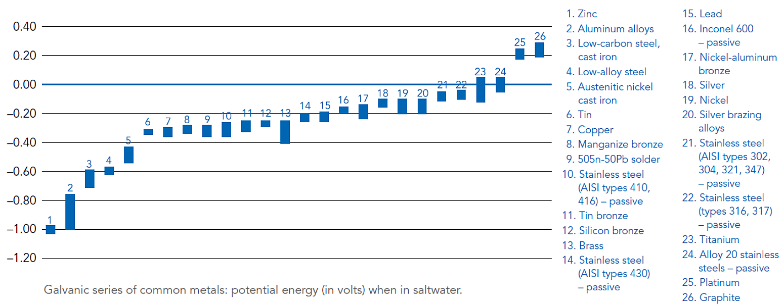

Primary Factors Affecting Rate of Galvanic Corrosion
Difference in electrical potential – Refer to the figure below for a Galvanic Series containing values for electrical potential of various metals in a saltwater application8. Generally, severity of corrosion increases when combining galvanized steel with metals far away from zinc in the galvanic series. Actual electrical potential values will vary depending on the specific electrolyte present if not saltwater4.
Galvanic Scale W Potential Energies Listed
Galvanic Series of Metals in Saltwater noting Electrical Potential Energy (in Volts) (Ref. 8)

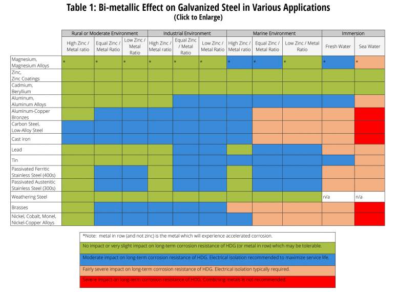

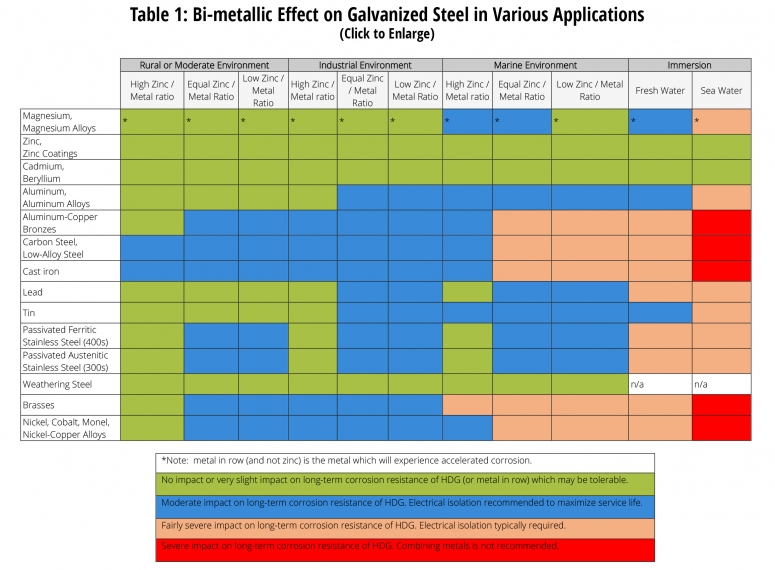

Bi-metallic effect on galvanized steel
The following table was developed by interpreting available corrosion data and indicates the impact of electrical potential, environment, and surface area ratios to predict the impact of galvanic corrosion on the long-term performance of galvanized coatings3,5,6. In some cases where moderate impact is predicted, galvanic corrosion may be tolerable on a project by project basis. As galvanic corrosion is a very complex corrosion issue with many variables, it is difficult to predict corrosion rates and the information below is provided for guidance only based on a limited set of variables.
Bi Metallic Effect On Galvanized Steel Graph Large 3
Table 1: Bi-metallic Effect on Galvanized Steel in Various Applications (Click to enlarge)

HDG Vent/Drain Hole Plugs – Tapered plugs made from zinc or aluminum are used to fill vent/drain holes on galvanized hollow fabrications such as handrail. Aluminum plugs are more economical and per Table 1 any moderate impact on service life in marine environments may be acceptable in service. For galvanized products placed in coastal or high humidity/chloride environments where maximum longevity is also a primary design consideration, the use of zinc plugs are considered.
