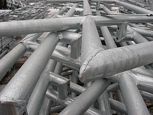

When welded items are galvanized, both the cleanliness of the weld area and the metallic composition of the weld itself affect the galvanized coating’s quality and appearance. It is recommended that the welds on the steel be of consistent thickness and symmetrical. The specifics of welding techniques can best be obtained from the American Welding Society (800-443-9353) or your welding equipment supplier. Several welding processes and techniques have been found to be successful for items to be galvanized.
Preferred Welding Processes
Welding processes such as gas metal arc welding (GMAW) or gas tungsten arc welding (GTAW) are recommended since they essentially produce no slag.
Welding Electrode Selection
When selecting a welding electrode, make sure that it provides a deposited weld composition as close as possible to the parent metal’s chemical composition. The composition compatibility will yield a more uniform zinc surface appearance. As with galvanizing high silicon steel, welding rods high in silicon may cause excessively thick and/or darkened galvanized coatings to form over the weld.

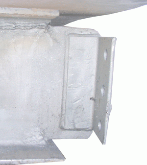

Seal Weld
Seal Weld
Seal-welding
If the gap between two surfaces to be welded is less than 3/32” (2.5mm), all edges must be completely seal-welded

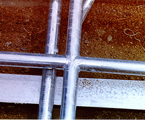

Stitch-welding vs. Continuous Welding
It is often beneficial to use stitch-welding techniques as opposed to continuous welding. If air is trapped in a seal-welded space it will expand rapidly upon immersion into the zinc bath. This may cause a sudden fracture of the steel structure. A stitch weld in conjunction with a gap of 3/32” (2.5mm) or more between pieces is suggested to avoid this.

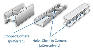

Induced Stresses, Differences in Steel Thickness
Venting and draining considerations.
Welding two parts together induces areas of increased stress around the weld joint. Warping and distortion may occur upon immersion into the molten zinc. Additionally, if the parts of the assembly are unequal in thickness, temporary bracing may be necessary to limit warping and distortion.
