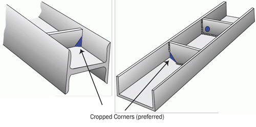

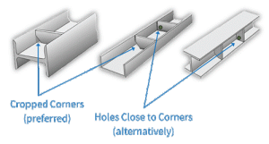

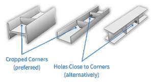

When hot-dip galvanizing, cleaning solutions and molten zinc must be able to flow into, over, through, and out of the part. Improper drainage design which impedes free  flow can cause complications for the galvanizer and the customer including: poor appearance, bare spots, and excessive build-up of zinc. These unnecessary and costly mistakes are a key example of the importance of communication early in the design phase of the project.
Following best design practices will ensure the highest quality coatings.  A few areas where drainage is especially important are gusset plates, stiffeners, end-plates, and bracing.  Use these guidelines:
  • Gusset plates should have generously cropped corners to provide for free drainage. If copping the gusset plates is not possible, place at least 1/2 (13 mm) holes as close to the corners as possible.
  • All stiffeners, gussets, and bracing should be cropped a minimum of 3/4 (19 mm) to ensure unimpeded flow of solutions.
  • To allow molten zinc access during immersion in the galvanizing bath and drainage upon withdrawal, provide holes at least 1/2 (13 mm) in diameter in end-plates on rolled steel shapes.
  • Alternatively, place at least 1/2 (13 mm) holes in the web within 1/4 (6 mm) of the end-plate. End-plates should have holes placed as close to interior corners as possible to facilitate drainage.
