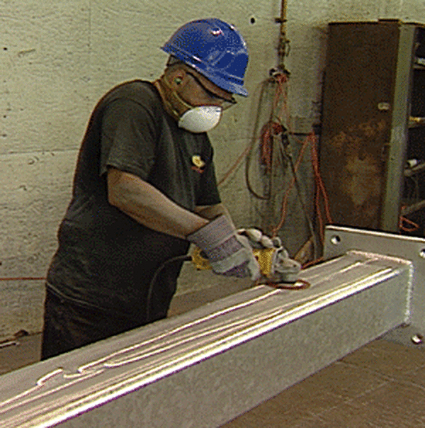

The touch-up and repair of hot-dip galvanized steel coatings is important to maintain uniform barrier and cathodic protection as well as ensure longevity. Although the hot-dip galvanized coating is very resistant to damage, small voids or defects in the coating can occur during the galvanizing process or due to improper handling of the steel after galvanizing. Touch-up and repair of galvanized steel is simple whether newly galvanized or in service for years. The practice is the same, but there are more restrictions to the allowable repairs on a new product than one that has been in service.

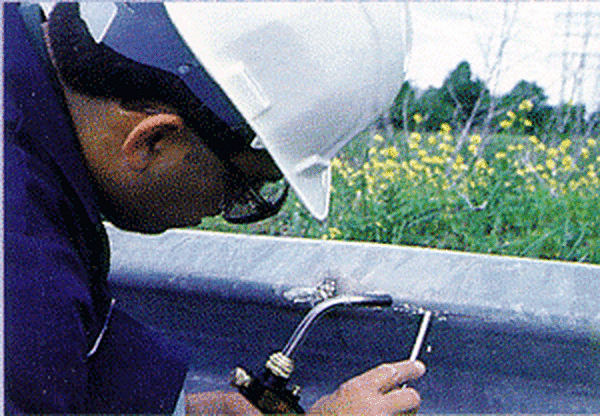

Zinc-Based Solders
galvanized steel touch up repair zinc solder soldering
Zinc-Based Solder
Soldering is done with zinc-based alloys in either a stick or powder form. The area being repaired needs to be preheated to approximately 600 F (315 C). The acceptable material compositions of solders used for repair are included in the ASTM A780. The repair coating thickness must meet the specification requirement for the material category of the part with a maximum thickness of 4 mils (100 µm). The thickness is measured by any of the non-destructive methods in A123/A123M.  Zinc-based solder products closely match the surrounding zinc and blend in well with the existing coating appearance.

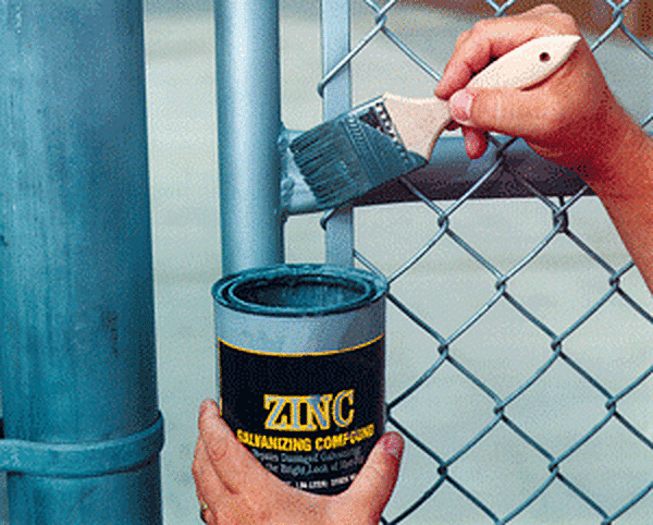

Zinc-Rich Paints
Zinc-Rich Paint
Zinc-Rich Paints
Zinc-rich paint is applied to a clean, dry steel surface by either a brush or spray. Zinc-rich paints must contain either between 65% to 69% metallic zinc by weight or greater than 92% metallic zinc by weight in dry film. Paints containing zinc dust are classified as organic or inorganic, depending on the binder they contain. Inorganic binders are particularly suitable for paints applied in touch-up applications of undamaged hot-dip galvanized areas. The coating thickness for the paint must be 50% more than the surrounding coating thickness, but not greater than 4.0 mils (100 µm), and measurements should be taken with either a magnetic, electromagnetic, or eddy current gauge to ensure compliance.

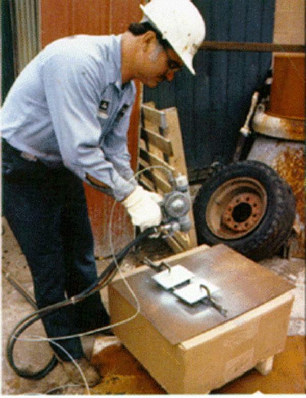

Zinc Spray
Metallizing (Zinc Spray)
Zinc Spray (Metallizing)
Zinc spray, or metallizing, is done by melting zinc powder or zinc wire in a flame or electric arc and projecting the molten zinc droplets by air or gas onto the surface to be coated. The zinc used is nominally 99.5% pure or better. The renovated area shall have a zinc coating thickness at least as thick as that required in ASTM A 123/A 123M for the material category. For best results, thickness measurements for the metallized coating should be taken with either a magnetic or an electromagnetic gauge.
