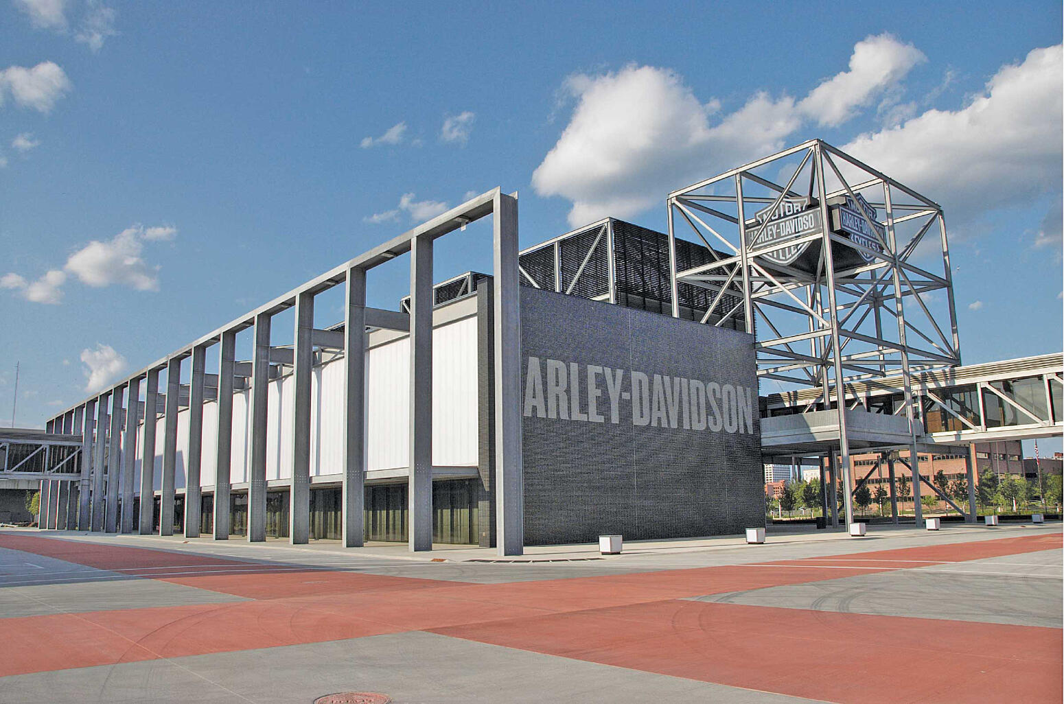

Harley Davidson Museum in Milwaukee, Wisconsin
The fact steel corrodes when exposed to the atmosphere should not be a deterrent to specifying the material; because, all construction materials (concrete, wood, etc.) do in fact deteriorate when exposed to the environment. However, steel is more upfront about its corrosion, the rust shows where weaknesses are forming allowing maintenance crews to focus their attention for repairs. Other materials may hide the issues until the problem is magnified. The best way to conquer corrosion is to provide steel with a protective coating, which has more than 150 years of proven, real world performance - hot-dip galvanizing.
