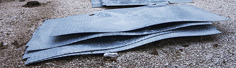

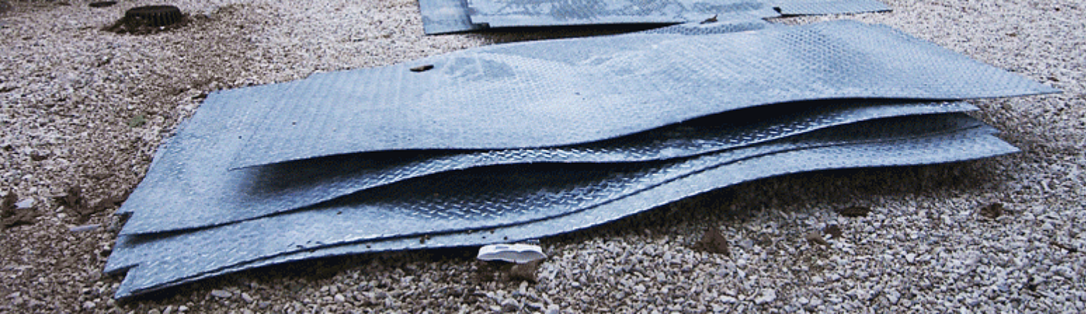

Distorted Steel Plate
Steel being galvanized progresses through a temperature cycle upon immersion into and withdrawal from the galvanizing bath. Because parts are immersed at an angle, uneven heating occurs, creating a temperature profile along the part being galvanized. This temperature profile allows the steel's internal stresses to be relieved at different times in the immersion cycle. These stresses may cause changes in shape and/or alignment (distortion and warping).
