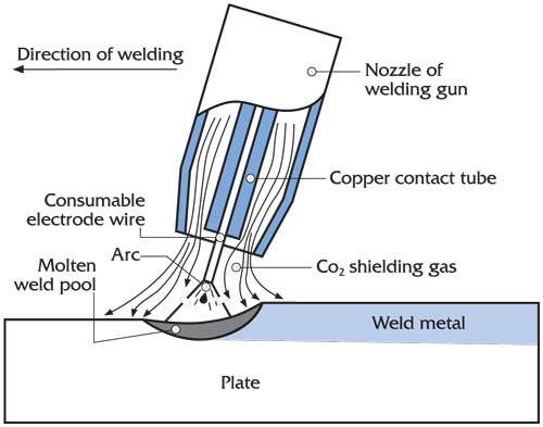

Gas Metal Arc Welding (GMAW)
Gas metal arc welding, also known as Metal-Inert Gas (MIG) welding, is a versatile semi-automatic welding technique particularly suited for the welding of thinner materials (<1/2 [13 mm] thick).
Welding speeds for GMAW are typically slower for galvanized surfaces. These reduced speeds allow longer time for the zinc to burn off at the front of the weld pool. Increasing the current supplied to the welding electrode may provide sufficient means to burn off zinc coatings of greater thickness.
![Welding Glavanized Steel Fig1](/uploads/dr-galv/_1000xAUTO_crop_center-center_75_none/welding-glavanized-steel-fig1.jpg)
Weld penetration depth is decreased when welding galvanized steel. When performing butt-welds, larger gaps must be provided. Consistent penetration is achieved by employing a side-to-side motion of the welding torch when butt-welding in the flat position. Spatter increases when welding galvanized steel using CO2 shielding gas. The formation of spatter particles is directly proportional to the thickness of the zinc coating. Therefore, spatter formation is greater for hot-dip galvanized steel than continuously galvanized (sheet) steel.
Spatter particles can adhere to the steel surface causing an unsightly appearance. Applying a silicon-, petroleum- or graphite-based spatter release compound before welding can reduce spatter adherence. These compounds allow spatter particles to be easily brushed off after welding.
Increasing the heat, reducing welding speed, and using an argon-CO2 shielding gas when GMA welding can give a more stable arc and produce smoother weld deposits with minimum spatter and zinc loss.
