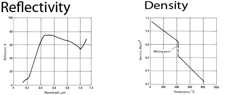

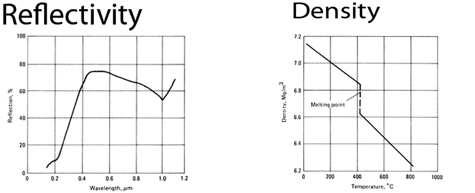

| Density | See chart below |
| Hardness | 2.5 mohs |
| Surface Reflectivity | See chart below |

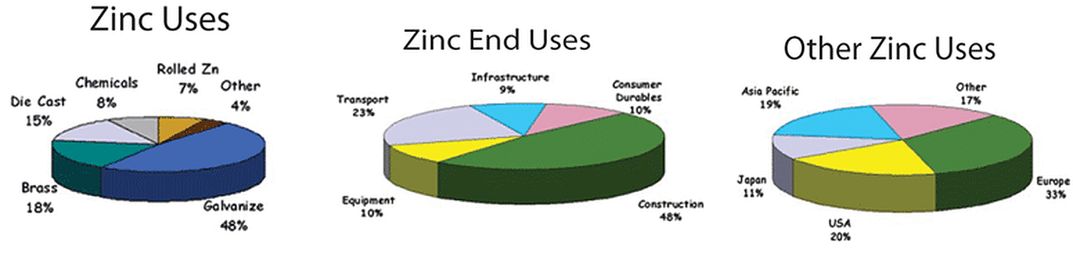

Other Uses of Zinc
