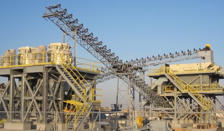

Galvanized steel on a recycling plant
Galvanized steel can be used in almost any environment. It will be able to withstand the corrosive elements while the longevity of the steel will not be affected
