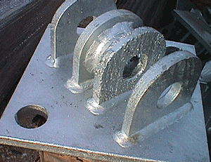

Steel Surfaces
Different Steel Surfaces Example

  • Rough steel surfaces created during fabrication or abrasive cleaning processes may cause thicker zinc coatings

  • Welding slag adhered to the steel surface must be removed prior to galvanizing.
    • Welding slag adhered directly onto the weld is easily removed by grinding
    • Welding slag adhered around the weld areas is more difficult to remove and usually cannot be ground away; other means of mechanical removal, such as blasting, must be used to remove it.
