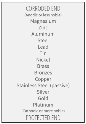

The galvanic series (Figure 2) lists metals that range from more anodic (less noble) to metals that are more cathodic (nobler). The farther apart the metals are in the galvanic series, the greater the electrical potential difference, which can influence galvanic corrosion. There are some instances where dissimilar metals do not have as great a potential difference as would be indicated by the galvanic series. For example, some metals, such as aluminum and stainless steel, may develop a passive layer on their surfaces that can act as an electrical insulator when in contact with a dissimilar metal.
