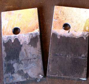

Masking is treating a portion of the steel surface so the area remains ungalvanized. Masking is not an exact science; additional work may still be required to remove unwanted zinc.
In some cases, it may be easier to grind off the zinc coating after galvanizing than to mask the material.
Samples from the Masking Study

In addition to these designated masking materials, the American Galvanizers Association conducted a study to determine which commercially available masking materials work best at preventing galvanizing on masked areas. Six commercially available masking materials were identified to successfully prevent galvanizing on one or more surface types, including flat plate, bolt threads, and buried threaded holes. For flat surfaces, greater than 90% of the masked area remained ungalvanized during testing. The successful masking materials included (in no particular order):
