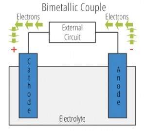

To understand the answer to this question, one needs to understand the pieces of a galvanic cell.  A galvanic cell contains four elements: an anode, a cathode, an electrolyte solution, and an electrical connection between anode and cathode. When working with hot-dip galvanized steel, the zinc coating is almost always the anode and a more noble metal (usually stainless steel, carbon steel, or aluminum) used in the design acts as the cathode. The electrical connection is created when anode and cathode are put into direct contact with one another. An electrolyte solution can be found easily in nature; varying from a seawater to a humid atmosphere. A galvanic cell must contain all four of these elements in order to function and cause accelerated corrosion. Eliminating one of these elements will eliminate the galvanic cell, therefore eliminating the accelerated corrosion process.

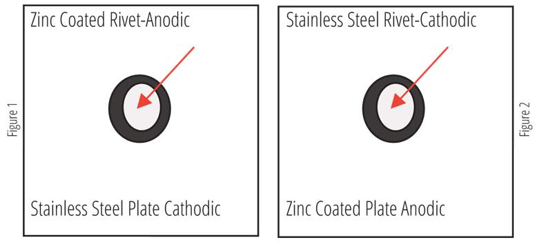

As with any design using dissimilar metals in contact, the surface areas of both the anode and the cathode will be a large factor in the severity of the galvanic corrosion observed. If there is a small anode (zinc) protecting a larger cathode (bare carbon steel), the corrosion seen on the zinc will be quite severe. However, if this setup is reversed, and the cathode is much smaller than the anode, the corrosion on the anode will be much less severe and may even be difficult to detect at all.
Dr Galvfigure1
With this principle in mind, it is clear painting only the more anodic metal (hot-dip galvanized steel), will lead to severe localized corrosion of the zinc coating. Holidays and chips in the coating will leave a very small surface area of the anode exposed to the electrolyte solution. This coupled with a large surface area of the cathode will cause severe corrosion in localized spots of the galvanized coating. Conversely, if only the more noble metal is painted, the small holidays and chips in the paint will create a small surface area on the cathode which can be protected by the rather large surface area of the anodic material.
