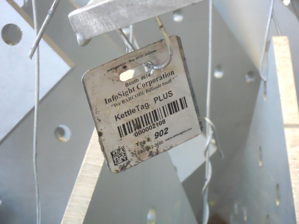

Temporary Identification
The most common form of temporary identification is the use of detachable tags. Whether barcode tags or stamped/stenciled tags, these are often preferred as they stay affixed to the part throughout the process, but can be removed once the steel is delivered to the job site. Because they are still readable after all phases of the galvanizing process, tags can facilitate turnaround time and eliminate lost parts while not affecting the aesthetics of the steel once erected.

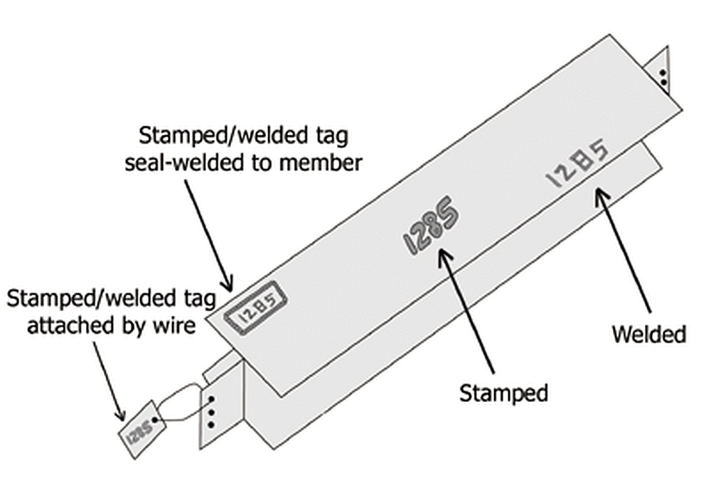

Where permanent identification is needed, there are three suitable alternatives for marking steel fabrications to be hot-dip galvanized. Each enables items to be rapidly identified after galvanizing and at the job site.

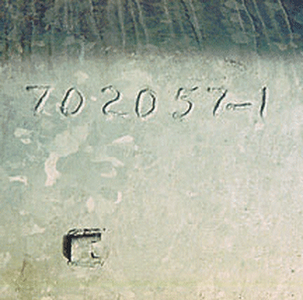

Stamping
Stamp the surface of the item using die-cut deep stencils or a series of center punch-marks. These marks should be placed in a standard position on each of the members, preferably toward the center. They should be a minimum
of 1/2-inch (13 mm) high and 1/32-inch (0.8 mm) deep to ensure readability after galvanizing. This method should not be used to mark fracture-critical members.
Weld Beads
A series of weld beads may also be used to mark letters or numbers directly onto the fabrication. It is essential that all welding flux be removed in order to achieve a quality galvanized coating.

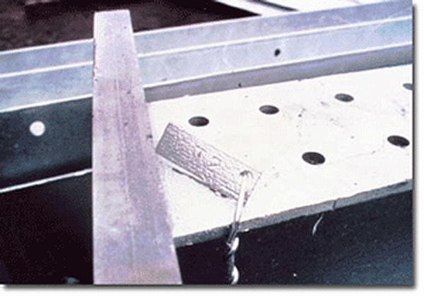

Deep Stenciling
Deep stenciling a steel tag (minimum #12 gauge) and firmly affixing it to the fabrication with a minimum #9 gauge steel wire is another option for identification. The tag should be wired loosely to the work so that the area beneath the wire can be galvanized and the wire will not freeze to the work when the molten zinc solidifies. If desired, tags may be seal-welded directly to the material.
