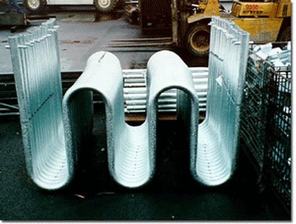

Many structures and parts are fabricated using cold-working techniques (bending, hole-punching, rolling, shearing). Severe cold-working increases the incidence of strain-age embrittlement. The effects of strain-age embrittlement may be accelerated by the galvanizing process, because aging is relatively slow at ambient temperatures but more rapid at the elevated temperatures encountered in the galvanizing process. (See also Bend Diameters).
Any form of cold-working reduces steel's ductility. Operations  such as punching holes, notching, producing fillets of small radii, shearing, or sharp bending may lead to strain-age embrittlement of susceptible steels. Cold-worked steels less than 1/8" (3 mm) thick subsequently galvanized are unlikely to experience strain-age embrittlement. Since cold-working is the strongest contributing factor to the embrittlement of galvanized steel, these tips  are recommended to reduce the incidence of strain-age embrittlement:

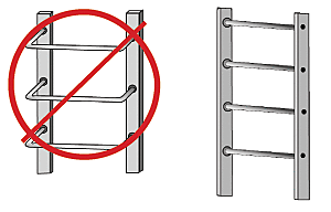

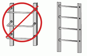

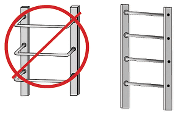

Wrong vs. Right way to  Bend Cold Worked Steel
  • Select steels with carbon contents below 0.25%.
  • Choose steels with low transition temperatures since cold-working raises the ductile-brittle transition temperature and galvanizing (heating) may raise it further.
  • Specify aluminum-killed steels; they show less susceptibility to strain-age embrittlement.
  • For steels with a carbon content between 0.1% and 0.25%, maintain a bending radius of at least three times (3x) the section thickness. If bending is required to be less than 3x, the material should be stress-relieved at 1100 F (595 C) for one hour per inch (2.5 cm) of section thickness.
