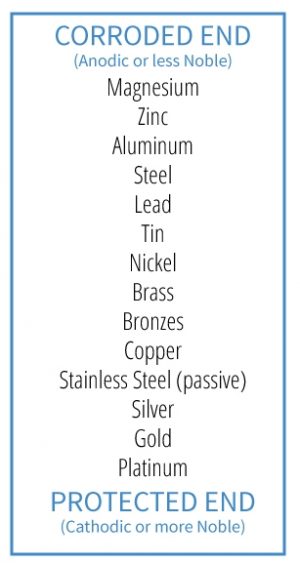

The reason for this is when two different metals such as zinc and aluminum are in contact in a corrosive environment, one of the metals experiences accelerated galvanic corrosion while the other metal remains galvanically protected. To determine whether this is a problem regarding vent/drain hole plugs, refer to the galvanic series of metals (Figure 1) for a listing of different types of metals and their corresponding electrical potentials in a salt water solution. Metals with a lower (more negative) electrical potential will sacrifice themselves for metals with a higher (more positive) electrical potential. When dissimilar metals are in contact, the metal with a lower electrical potential is called the anode, and the metal with a higher electrical potential is called the cathode. The anode provides protection to the cathode, and in the process of providing this protection, the anode material is sacrificed.
In addition, the relative surface areas of the contacting dissimilar metals are relevant in determining the corrosion rate of the anode material. For example, when dissimilar metals are in contact, it is more desirable to have a large anode surface in contact with a small cathode surface to give the anode a very slow corrosion rate.
So the next time your customer asks Which is better? Do I need to worry about galvanic corrosion with vent/drain hole plugs? you can provide the following explanation:
Aluminum is next to zinc on the galvanic scale, meaning the combination of these materials results in only a minor effect on each other. In addition, the use of aluminum plugs results in a favorable anode-to-cathode ratio where the large anode surface (zinc) is in contact with a small cathode surface (aluminum plugs). Therefore, in most applications involving environments without high humidity and/or chlorides, it is more likely the galvanized coating will suffer (at the most) only very slightly additional corrosion due to galvanic corrosion, which is usually tolerable in service. On the other hand, there is no concern regarding galvanic corrosion when using zinc plugs as both the plugs and hot-dip galvanized coating are comprised of the same metal. Therefore, zinc plugs are more suitable for projects requiring maximum design life in corrosive environments, including high humidity/chloride environments.
