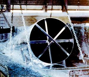

Temporary Bracing During Galvanizing
Most fabrications lend themselves well to the galvanizing process, including asymmetrical designs or structures containing sections of unequal thickness.
It is important to understand that, because during galvanizing steel is exposed to temperature variations, fabrications of asymmetrical design or with sections of unequal thickness can exhibit different thermal expansion and contraction stresses, leading to changes in shape and/or alignment (distortion and warping).

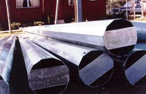

Temporary Bracing Hollow Structure
Bracing
  • Welding- or bending-induced stresses that reside in the material after fabrication may  be released during galvanizing, also resulting in structural changes in shape and/or alignment.
  • Bracing — permanent or removable after galvanizing — provides stability during the thermal expansion and contraction cycle. Occasionally, when bracing is not used and warping and/or distortion occur, the part will return to its original shape during cool-down.
