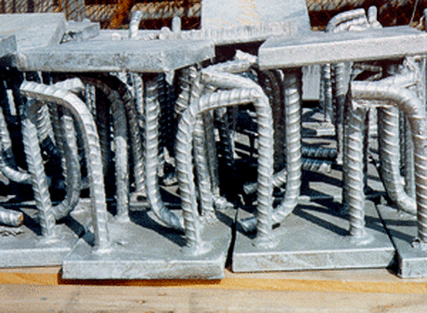

Bent Rebar
Since steel being galvanized is going through a temperature cycle from ambient temperature to molten zinc's temperature of more than 800 F (420 C) and then back down to ambient temperature, mechanical property changes can occur, including an aging of areas on steel parts where there is a significant amount of cold-working, such as bends. This aging is called "strain-age embrittlement." When the cold-worked and galvanized part is later put in service, a fracture of the bend may occur. Fractures characteristically occur at the toe of the bend where the highest induced stress resides. If bends sharper than three times the section thickness are necessary, thermally heat-treat (stress-relieve) the article after bending - prior to galvanizing - in order to reduce the retained stress level in the steel article. To stress-relieve, the part should be heat-treated at 1100 F (593 C) for one hour per inch (2.5cm) of section thickness.
