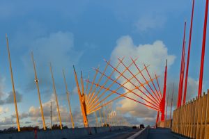

Council Bluffs
Council Bluffs Gateway

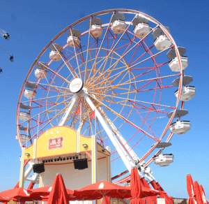

Galaxy Wheel at Galveston Island's Pleasure Pier

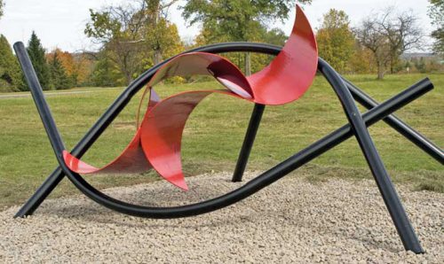

Peels Sculpture
Peels Sculpture
