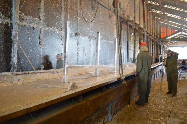

In the progressive dipping process, half of the article is lowered into the kettle first, removed, and then the other half is dipped to complete the hot-dip galvanized coating. There are some unique challenges when it comes to progressive dipping, and it is crucial to have direct communication with the galvanizer early in the design phase to address the following concerns:
Maximum Article Size for Progressive Dipping Because progressive dipping is simply the process of coating the steel part in two passes, only half of the article length or height must fit into the kettle to coat the entire article by this process. In other words, if at least half of the piece can fit in the bath, the part can be galvanized on one side, re-hung, and then dipped on the remaining surface. In essence, this would nearly double the article size that can be coated, depending on the kettle and article dimensions. However, it is important to consider that when increasing the length and height of the article beyond the kettle size for progressive dipping, the kettle width becomes the primary dimensional constraint. The width of the article must still be kept within the kettle width dimension in order to place the article partially within the bath. Kettle dimensions for all member galvanizers can be confirmed on the AGA website.

Lifting Orientation and Handling The maximum article size which can be progressively dipped may be further limited by the layout and lifting capabilities of the hot-dip galvanizing plant. Discuss lifting orientation and lift points directly with the galvanizer to avoid clashing of the article with nearby walls or equipment at the plant for both passes to produce the coating. Additionally, confirm the article weight is within the safe working load limit of the available lifting equipment.

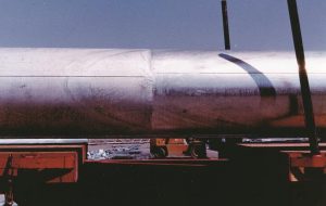

Overlap Line
Overlap Line Progressively dipped pieces often have an overlap area that is visible on the piece. The line or darker area is purely cosmetic and will fade over time as the coating weathers naturally. As the overlap area will most likely develop a thicker coating, it is important to consider if the excess zinc will impact a connection point with other pieces. If required, the excess coating thickness can be buffed or ground down to match the surrounding coating.
