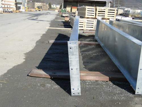

Warpage and distortion of hot-dip galvanized steel can be prevented with proper design procedures. However, there are still times when a design flaw will lead to warped steel after the galvanizing process. If warped steel parts do result, they may be recoverable. For example, the fabrication below is not severely out of a plane and is made of relatively thinner steel. It may be possible to bend this steel back into its correct shape or clamp and bolt it into place as is.

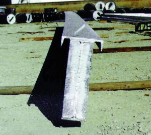

Thicker pieces that are severely out of a plane like the steel shown below may not be recoverable. It may be extremely difficult to bend the steel back into place and may also damage the coating.

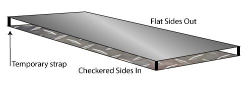

Theres also an option to make an asymmetrical piece into a symmetrical shape. The unrecoverable beam we saw before, for example, could have been made more symmetrical by welding a similar U-shaped piece to the bottom as well as the top. This could cause the internal stresses in the bath to counteract each other and prevent the piece from warping.
Checker plate is asymmetrical by nature but can be made into a temporary shape that is more symmetrical. If two pieces of the plate are welded face to face with temporary straps, the new symmetrical shape will be much less likely to experience warpage and distortion.
