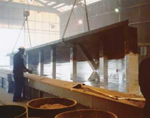

Some fabricated structures and assemblies may distort at the galvanizing temperature as a result of relieving stresses induced during steel production and in subsequent fabricating operations. In general, the potential for warpage/distortion can be greatly reduced through design and production engineering measures to avoid high internal stresses. The best prevention is to start discussions between the designer, fabricator, and galvanizer at an early stage in the design process so that good design features can be incorporated.

Progressive  Dip  B 72Dpi
Progressive Dip
Progressive Dipping
