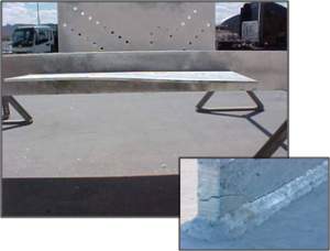

Figure2
Figure 2: Plate Welded to Side of Beam
Figure 2 shows a fabrication where a plate was welded to the side of a beam. When this fabrication was brought up to galvanizing temperature, the thermal expansion proceeded at different rates for the beam and the plate. This put considerable stress on the plate as it tried to expand more rapidly than the beam, however, the welding together of the two materials did not allow for separate movement. Since the plate material cannot move near the weld joint, it relieved the stress build-up by distorting away from the weld joint and cracking the weld joint.

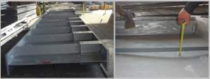

Figure3
Figure 3: Assymetrical Design in Material, Thickness, and Welding
The design of the fabrication in Figure 3 was problematic because of asymmetry in the distribution of material and the overall welding design. Additionally, a thin plate was constrained between two thicker plates by welding. When this assembly reached galvanizing temperature, the thin plate expanded more rapidly than the surrounding materials.  The amount of welding and material on either side of the plate unevenly constrained the movement of the thin plate, and the additional stress was relieved through buckling of the plate up to one inch as shown in the picture on the right.
