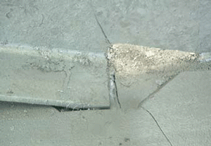

When galvanizing a frame structure, we took it out of the kettle, and I noticed some small cracks around one of the weld areas. What is causing this cracking?

Zinc can be pulled into a crack by wicking action, which will cause the crack to expand and grow. The heat-affected-zone is a highly stressed location. When the conditions are above the yield stress of the material, the steel reacts by forming a small crack somewhere near the weld area as delineated by the markings on the piece to the left.
