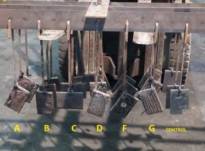

Twenty five years ago, the AGA evaluated the corrosion resistance of various weld materials to molten zinc and established a list of six materials recommended for kettle repair and the fabrication of fixtures or racks. Unfortunately, some of the weld materials that were tested previously are no longer being produced today. To update the existing list, a new set of welding electrodes was tested in 2017 upon consultation with Lincoln Electric (Figure 1). The scope was expanded beyond stick welding (SMAW) rods and flux-cored arc welding (FCAW) wires, and now includes a submerged arc welding (SAW) electrode for faster weld deposition. These materials were immersed in a galvanizing kettle of molten zinc and some were removed at 1 month, 3 month, and 6 month test periods. The updated list of recommended welding materials in Table 1 includes the new welding materials from the updated study which showed similar weight loss to the unwelded control sample or base metal. Generally, it was determined that weld materials with a silicon content less than 0.25% tend to work well in contact with the molten zinc.

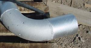

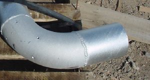

Table 1 can also be used to specify welding materials that are suitable for use during fabrication where welding is performed before hot-dip galvanizing. When the selected welding rod material is more reactive than the surrounding steel, a different appearance over the weld can be expected which is often duller in appearance, rougher, and thicker (Figure 2). However, the latest results of the Welding Rod Study indicate that the Silicon content (% Si) of the weld material does not necessarily follow the pattern of galvanizing reactivity as shown by the Sandelin Curve. Although the Sandelin curve is a useful chart for determining the reactivity of steel to be hot-dip galvanized, it may not be a useful metric when trying to match weld material reactivity to base metal reactivity to achieve similar coating thickness and appearance. Where unsure, the welding materials listed in Table 1 can be used to reduce coating thickness over the welds, resulting in a more uniform appearance overall.
