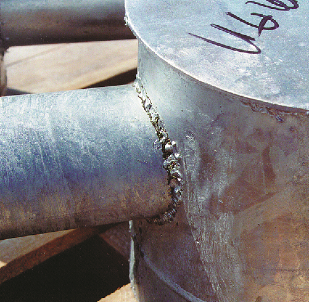

Welding slag, flux residues, and welding sprays (except for water-soluble sprays) must be fully removed prior to galvanizing. Welding flux residues are chemically inert in the chemical cleaning solutions commonly used by galvanizers; therefore, their existence will produce rough surfaces and coating voids. If a coated electrode is used, all welding flux residues must be removed by wire brushing, chipping, grinding, pneumatic needle gun, or abrasive blast cleaning. Alternatively, an uncoated electrode can be used where possible to prevent flux deposits on the steel or product.
Slag
Figure 1: Bare spots and poor HDG quality near weld due to presence of slag
Figure 2 Good
Figure 2: Appearance and poor quality due weld spatter

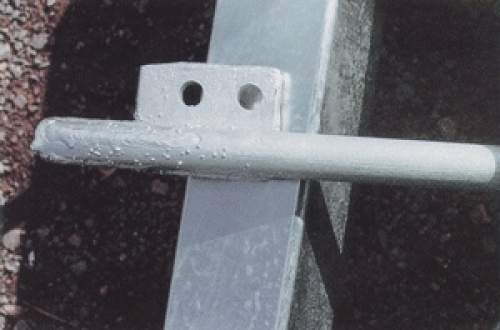

Welding electrodes high in silicon (>0.25% Si) may cause excessively thick and/or darkened galvanized coatings to form over the weld. When smooth products are welded using high silicon electrodes, the coating over the weld material will be thicker than the surrounding coating, causing a raised weld in an otherwise smooth product. This appearance is sometimes referred to as a "raised weld" or "swollen weld." Specifying ground welds before galvanizing does not successfully prevent this condition, but can be specified when weld show through is required to be minimized and a reactive welding electrode cannot be avoided.
Figure 3 Good
Figure 3: Welding electrodes high in silicon results in a raised weld appearance despite grinding smooth and commercial blast cleaning prior to hot-dip galvanizing.
Instead, it is possible to specify a welding electrode with a chemical composition as close as possible to the parent metal to minimize differences in appearance and potential costs associated with smoothing welds after galvanizing. A list of welding electrodes which are known to promote a more uniform appearance are provided in Table 1. In some welding processes (e.g. FCAW-G), the availability of low silicon welding electrodes may be uncommon.

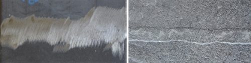

Figure Unsmoothed Weld Recommended Chem
Figure 4: Appearance of weld using a recommended electrode and no grinding/filing before HDG (standard weld cleanup for galvanizing).

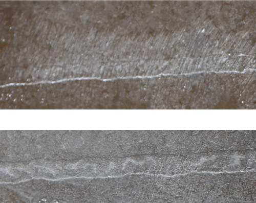

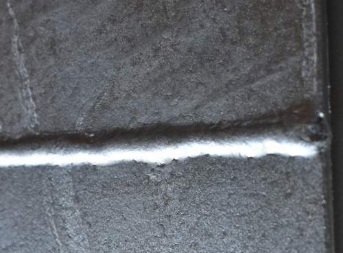

Figure Grind Vs Grind And Blast Weld
Figure 5: Appearance of weld smoothed with grinder before HDG showing grinder markings (top) vs. appearance of weld ground and commercial blast cleaned before HDG with grind marks minimized (bottom).

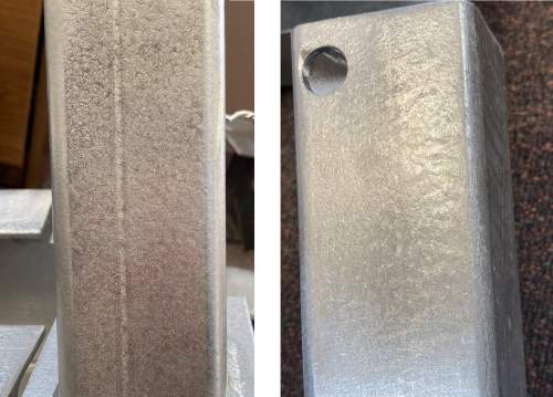

Figure Grinding Hss Seams
Figure 6: Unground HSS seams are visibly apparent after galvanizing (left) but are minimized – not eliminated – when ground and commercial blast cleaned before hot-dip galvanizing (right).
