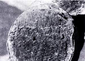

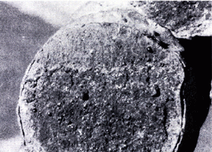

Figure 1
Strain-aging has received much attention in the galvanizing field because of its tendency for rapid aging of materials at the galvanizing temperature. This causes a loss of ductility, which frequently results in a brittle fracture during the ordinary process of handling and erection. It is vital for the fabricator to avoid this type of failure through changes in the engineering design, hot forming, heat treatment after fabrication, and or the selection of steels less susceptible to this failure.
The process of punching or bending circumpresses and distorts the metal around the circumference of the hole or bend. This generally starts slight tears or cracks in the material. The possible cause of embrittlement is the penetration of the zinc into the steel, particularly at these cracks and tears in the bed or near the punch holes. This penetration is shown in Figure 1. Deep penetration occurred mostly along the longitudinal axis of the bend.
