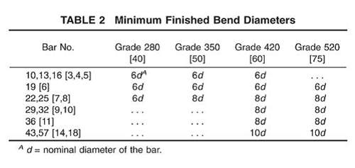

ASTM A143/A 143M recommends a bend diameter of at least three times (3X) the steel diameter for intermediate and heavy shapes, plates, and hardware. This recommendation does not apply to reinforcing bar. Recommended bend diameters for rebar are included in ASTM A767/A767M and are shown in the table below. Reinforcing bar and other types of steel can be bent tighter than these recommendations if necessary though as long as the steel is annealed prior to galvanizing or formed while hot. If tighter bend diameters than recommended are used and the steel is bent cold, the steel must be stress-relieved by heating the steel to temperatures between 900 to 1050°F (482 to 566°C) for one hour per inch of steel diameter prior to galvanizing.

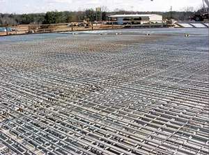

Different types of steel have different properties, including chemistry, strength, aging characteristics, etc., and these properties will influence the cold working properties of the steel. Because most black steel reinforcing bar is made primarily of scrap iron and has many different steel chemistries, different bend recommendations are necessary. This is because of the varying properties of the steel with varying chemistries.
