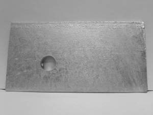

The masking materials were tested on three different types of surfaces; flat plate, buried threaded holes, and bolt threads. Two types of flat plate were used in the study. The first type of flat plate (see Figure 1, next page) was approximately 3” x 6”. The masking materials were applied to the steel away from the hole. The masking area had a width of 3” and a length of a little less than 4”.
All masking materials were applied to the steel prior to the cleaning steps of the galvanizing process, meaning the masking materials were subjected to a caustic bath, pickling bath, and flux bath. It was
important to determine if the masking materials could survive the cleaning chemicals, because if they could survive, the masking materials could be applied at the fabricator’s facility, and thereby save the galvanizer the time and trouble of applying the materials.
Masking1
Figure 1: Flat Plate

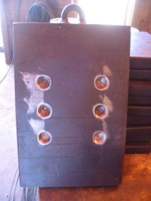

Some of the plates were drilled and tapped to provide a plate with a buried threaded hole to test the masking materials (see Figure 2). The buried threaded holes were 2½” deep holes drilled into a 3” thick plate (see Figure 2). Buried threaded holes were used only in Phase 1 testing. The bolts used in the study were ¾” in diameter and approximately 2 ½” in length (see Figure 3).
The masking materials were applied to the plates with a foam brush and then spread in the masked areas until an even consistency was achieved.
For the buried threaded holes the masking products were simply poured or squeezed into the holes.
Mask2
Figure 2: Buried Threaded Holes Plate

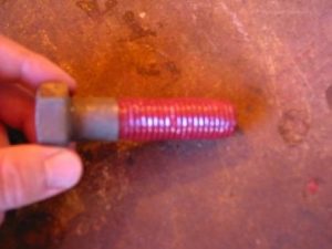

For the bolt threads, the masking materials were applied by either dipping the bolts directly into the bottle of the material, if there was enough room, or spread onto the threads using a foam brush. The material was spread onto the threads to achieve even thickness.
The masking materials for all surface types were applied prior to the chemical cleaning steps of the galvanizing process. This ensured the masking materials could stand up to the cleaning agents and would remain on the steel prior to galvanizing.
Masking products were removed by using a metal-bristled brush. The materials were scrubbed off the surface and then compressed air was used to blow off the debris. In Phase 2 testing, scrubbing the cleaned steel with a nylon bristled brush and Simple Green solution was also performed to determine if the original steel finish could be restored. A grinder was also tested in Phase 2 for removing the materials on flat plate.
Mask3
Figure 3: Coated Bolt Threads
