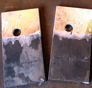

Masking products are applied to specific areas of steel when the galvanized coating on those areas would interfere with the end use of the product (such as on faying surfaces), or when additional work needs to be done on masked areas and a galvanized coating would make the work more difficult or expensive (such as on areas that will be welded or on fasteners that cannot have any additional width from a zinc coating). Of course, any time steel is masked, there will be no corrosion protection of the steel in those areas. The unmasked areas will not affect the corrosion protection of the galvanized coating in other areas to any large extent.
Many different types of materials have been used to mask steel during hot-dip galvanizing. High temperature paints used for masking are applied to flat surfaces that require the absence of a galvanized coating. The most common application of this is when areas of the steel are to be welded after galvanizing, such as stud welding. The paints can be removed after galvanizing by grinding or brushing, depending on the size of the area that has been masked. Greases and pastes that are resistant to the conditions of the galvanizing process are typically used on internal threads or threaded holes. When pastes are moistened with a little water, they can be pressed into holes and openings; it is essential that care is taken not to trap air in these holes. The paste hardens with the heat of galvanizing and prevents ingress of zinc. It will then be necessary to remove the residue after galvanizing by means of brushing. Adhesive tapes are used on cylindrical components, such as threaded bolts or pins. The tape carburizes in the galvanizing kettle and the residue that remains prevents the galvanizing reaction from occurring. This residue must be removed after galvanizing by using a stiff bristled brush. Another method of masking used to prevent unwanted coating on internal threads or clearance holes is the use of filler bolts or pins. A bolt or pin is greased prior to insertion in the hole and removed after galvanizing. Heat may be required to remove the bolt or pin as the zinc coating may lock the bolt or pin in place.

In the years since the AGA’s 2010 study, masking products have left the market, and new products have come to light. Here’s an updated list of masking products tested by the AGA and found to adequately prevent galvanizing.
- GE 100% Silicone Caulk (Home Depot, Lowes)
- Maskote Zinc Stop-Off (Pyrotek)
- Permatex Red RTV (formerly NAPA RTV Red) (Amazon)
- GalvaStop (HUB Industrial, Puma Chemical)
- DAP Household Adhesive Sealant (Home Depot, Lowes)
Here are some products that our galvanizer members have successfully used to mask parts with but have not been tested by the AGA:
- Plasti Dip (Amazon)
- ProCoat Galvbloc Zinc Stopper (TecCoat)
- Kem Bond HS Universal Metal Primer (Sherwin Williams)
*Products may not be exclusively available from our list’s sources.
Full details of the study can be found in the Galvanizing Note Masking Materials for Preventing Hot-Dip Galvanizing. For more detailed information on how each masking material performed on the various surface types, and application and removal data, please see the charts in Appendix 1.
It is important to remember that no masking material is 100% effective (there will always be some minor areas to clean up afterward), but if applied properly, they are quite effective at minimizing cleanup after HDG. Also, be sure to apply masking materials in accordance with the manufacturer’s instructions regarding cure times, application temp, humidity, surface cleanliness, etc. This will help the material’s adherence and ultimately performance.
