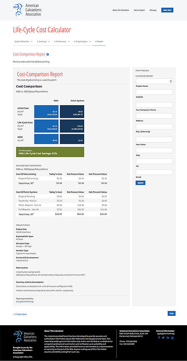

Once you launch the calculator, you will be prompted to enter specific details about your project such as the total tonnage or surface area, coating type, surface preparation required, atmospheric exposure condition (rural, industrial, coastal), and desired service life. The LCCC will then run a complex calculation based on established financial industry equations to determine the value of money over time including net present value (NPV) and net future value (NFV). The LCCC automates the exact equations from the recently released specification ASTM A 1068, Practice for Life-Cycle Cost Analysis of Corrosion Protection Systems on Iron and Steel Products.

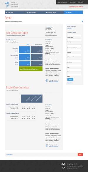

After you complete the three quick input screens with project details, the Life-Cycle Cost Calculator will generate a customized, printable report detailing the initial and life-cycle cost of hot-dip galvanizing compared to the system you selected.
