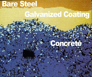

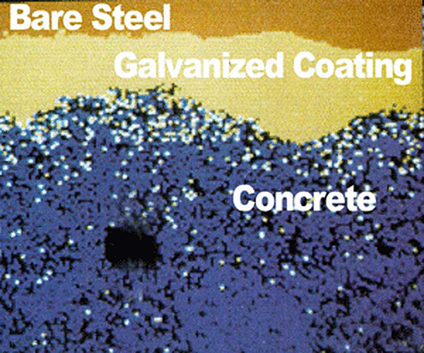

Concrete is an extremely complex material. The use of various types of concrete in construction has made the chemical, physical, and mechanical properties of concrete and its relationship to metals a topic of ongoing studies. Reinforcing steel bars (rebar) are embedded in concrete to provide strength, and are critical to the integrity and performance of the structure throughout its life. As concrete is a porous material, corrosive elements such as water, chloride ions, oxygen, carbon dioxide, and other gases travel into the concrete matrix, eventually reaching the rebar. Once the concentration of these corrosive elements surpasses steels corrosion threshold, the rebar starts to corrode. As the rebar corrodes, pressure builds around the bar leading to cracking, staining, and eventually spalling of the concrete.
![Galvanized rebar elemental map](/uploads/default/_600xAUTO_crop_center-center_75_none/galv_rebar_element_map72.gif)

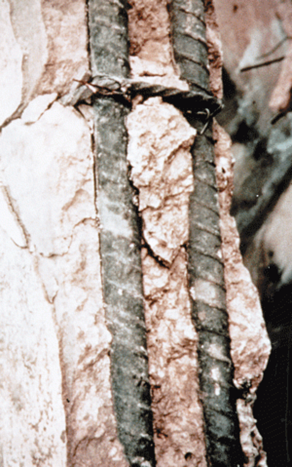

Because failure of the rebar leads to compromised or failing structural capacity, protecting against premature rebar failure is key. Similar to in the atmosphere, galvanized rebar extends the life of the steel in concrete. The corrosion mechanisms in concrete are quite different than atmospheric exposure, and one of the biggest factors is chloride concentration. Galvanized rebar can withstand chloride concentration at least four to five times higher than black steel, and remains passivated at lower pH levels, slowing the rate of corrosion. In addition to the higher chloride tolerance, once zinc corrosion products are formed from the galvanized rebar, they are less voluminous than iron oxide and actually migrate away from the bar. The less voluminous zinc particles migrate away from the bar (galvanized coating) and into the pores of the concrete matrix. This migration prevents the pressure buildup and spalling caused by iron oxide particles.
![Galvanized rebar](/uploads/default/_600xAUTO_crop_center-center_75_none/Rebar2.gif)
The total life of galvanized steel in concrete is made up of the time taken for the zinc to depassivate, plus the time taken for consumption of the zinc coating, as it sacrificially protects the underlying steel. Only after the coating has been fully consumed in a region of the bar will localized steel corrosion begin. Laboratory data support, and field test results confirm, that reinforced concrete structures exposed to aggressive environments have a substantially longer service life when galvanized rebar is used as opposed to bare steel rebar.

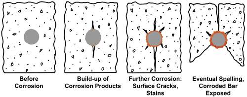

![rebar corrosion process illustration](/uploads/default/_1000xAUTO_crop_center-center_75_none/graph.gif)
The corrosion mechanisms and performance of black and hot-dip galvanized steel in concrete are different than when exposed to atmospheric conditions. Steel embedded in concrete is exposed to a highly alkaline environment. Black steel is passive in alkaline concrete until the chloride level exceeds approximately 1 lb/yd3, when steel becomes depassivated and starts to corrode. Zinc, on the other hand, can withstand chloride concentration at least four to five times higher than black steel, and coupled with its impervious barrier protection, delays the onset of chloride corrosion on galvanized rebar.
Chlorides penetrate the concrete through small pores and cracks that form on the surface through use and weathering. While black steel in concrete typically depassivates below a pH of 11.5, galvanized reinforcement can remain passivated at a lower pH, thereby offering substantial protection against the effects of concrete carbonation.
In addition to the higher chloride tolerance, once the zinc coating does start to depassivate, the zinc corrosion products formed are less voluminous than iron oxides and actually migrate away from the galvanized bar into the matrix of the concrete. Unlike the development of iron oxide, the migration of the zinc corrosion products from the rebar prevents the pressure buildup and eventual concrete spalling.
The total life of a galvanized coating in concrete is made up of the time taken for the zinc to depassivate (which takes longer than black steel because of its higher tolerance to chloride ions), plus the time taken for the consumption of the zinc coating as it sacrificially protects the underlying steel. Only after the coating has been fully consumed in a region of the bar will localized corrosion of the steel begin.

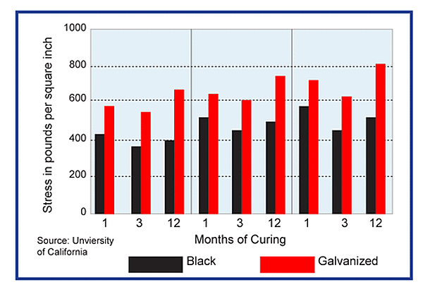

Bond Strength Test
The bond of the hot-dip galvanized reinforcing bar to the concrete can be tested according to ASTM A944, Test Methods for Comparing Bond Strength of Steel Reinforcing Bars to Concrete Using Beam-End Specimens. The bond strength relies heavily on the deformation of the bar and not as much on the actual bond between the zinc and the concrete. For plain bars with no deformation, the bond between the zinc and the concrete becomes very important. Pullout strength of hot-dip galvanized reinforcing steel has been tested many times, and the values of bond strength are equivalent to, or better than, black steel bond strength.

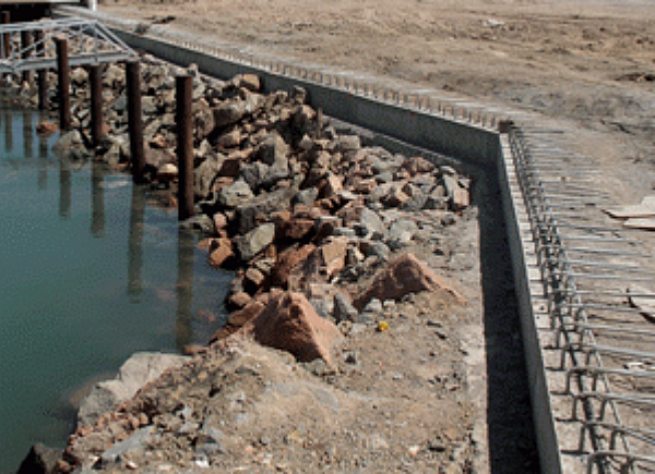

Zinc Reaction in Concrete
![Townsville Reinforcing Wall](/uploads/default/_600xAUTO_crop_center-center_75_none/Townsville-Reinforcing-Wall.png)
During curing, the galvanized surface of steel reinforcement reacts with the alkaline cement paste to form stable, insoluble zinc salts accompanied by hydrogen evolution. This has raised the concern of the possibility of steel embrittlement due to hydrogen absorption. Laboratory studies indicate liberated hydrogen does not permeate the galvanized coating to the underlying steel and the reaction ceases as soon as the concrete hardens.
ASTM A767 requires hot-dip galvanized reinforcement be chromate passivated after galvanizing. Many cement mixtures contain small amounts of chromate that may serve the same purpose as chromate passivating the zinc coating. The reaction between the alkaline cement paste and the zinc coating is dependent on the amount of zinc-coated surface in the concrete with the potential for reaction increasing with more zinc metal in contact with the concrete.

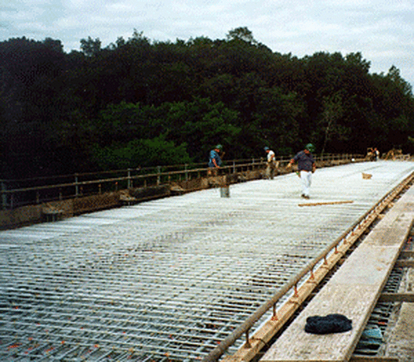

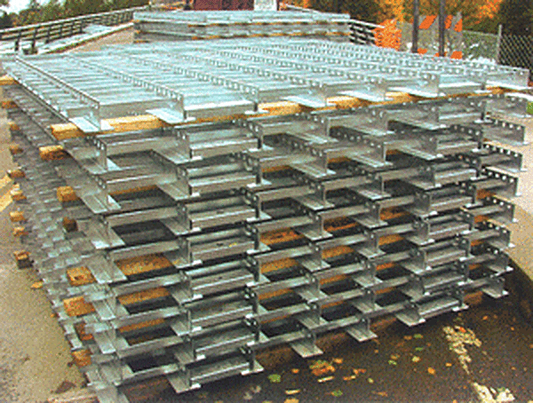

Removal of Forms
![galvanized forms](/uploads/default/_600xAUTO_crop_center-center_75_none/form.gif)
Metal forms should be electrically isolated from the galvanized rebar to prevent dissimilar metal reactions during the concrete curing. If metal forms are not isolated from the galvanized rebar, then zinc ions can be released from the galvanized coating to try to protect the metal form, resulting in a change in the concrete appearance near the galvanized bar placement.
Because types of cement with naturally low occurring levels of chromates may react with zinc, it is important to ensure that forms and supports are not removed before the concrete has developed the required strength to support itself. Normal form removal practices may be utilized if the cement contains at least 100 ppm of chromates in the final concrete mix or if the hot-dip galvanized bars are chromate-passivated according to ASTM A767.
