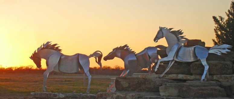

Wild Stallions
Aesthetics are important to nearly every construction project. Whether an attractive, artfully designed sculpture, architecturally exposed steel element, bridge, bus station, or other infrastructure element, galvanized steel offers design flexibility, and an attractive, natural gray finish, or if a color is desired it can be easily painted or powder coated.

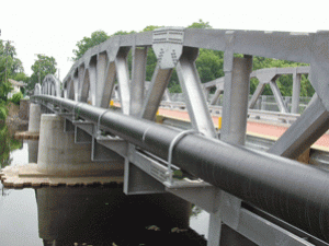

Bergen County Bridge
For some galvanized steel projects, such as electric substations, solar panels, or rail line infrastructure, the goal is often to blend seamlessly with the surroundings. As galvanized steel weathers and the zinc patina forms, the coating becomes a uniform matte gray. Whether in rural, wooded areas that are wildlife sensitive or in the city where non-reflectivity is important, the natural, non-intrusive finish of hot-dip galvanizing compliments and blends in with any environment.

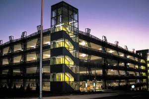

Children's Hospital Parking Garage
In addition to providing a natural, blendable appearance, utilizing hot-dip galvanizing on architecturally exposed structural steel (AESS) provides visual peace of mind the steel is in good condition. AESS elements are often designed to be centerpieces and talking points of steel construction.
The high strength-to-weight ratio and ductility of steel allow for curves, arches, and intricate patterns and designs when planning AESS elements. However, when AESS elements are exposed to the atmosphere, it is important to ensure they remain beautiful design elements by protecting them against corrosion. Hot-dip galvanized AESS elements can fight corrosion for decades without stifling your design freedom.
