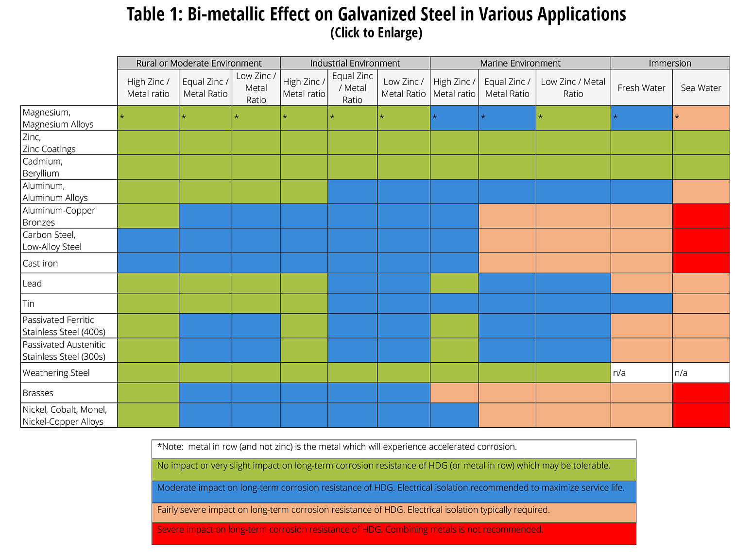

The behavior of galvanized coatings in contact with various metals is summarized in the table below. The information given is provided as a guide to avoid situations where corrosion may occur when galvanized surfaces are in contact with another metal.

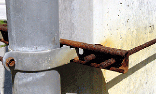

Iif galvanized steel and black steel are specified to be connected in concrete between different mesh layers of an exposed panel or the upper section only of reinforcement in a pile foundation in the ground, accelerated corrosion of zinc occurs after depassivation of the galvanized rebar in concrete10. Though depassivation does not often occur for decades, galvanic corrosion should be especially considered for high chloride environments (i.e. heavy road salting or marine environments). Common mitigations include galvanizing all rebar, supports, spacers, and tying wire; applying dielectric tapes for electrical isolation; and increasing concrete cover over the connection point.
Bi Metallic Effect On Galvanized Steel Graph Large 3
Bi-metallic Effect on Galvanized Steel in Various Applications (Click to enlarge)
