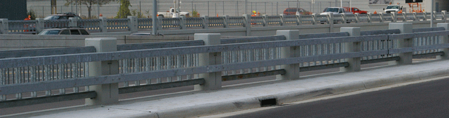

M102 Railing
M-102 Project reused HDG railing

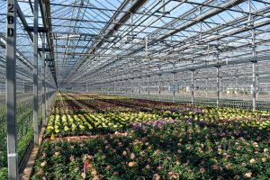

Metrolina Greenhouses
Metrolina Greenhouses in North Carolina have been using HDG since the 1970's

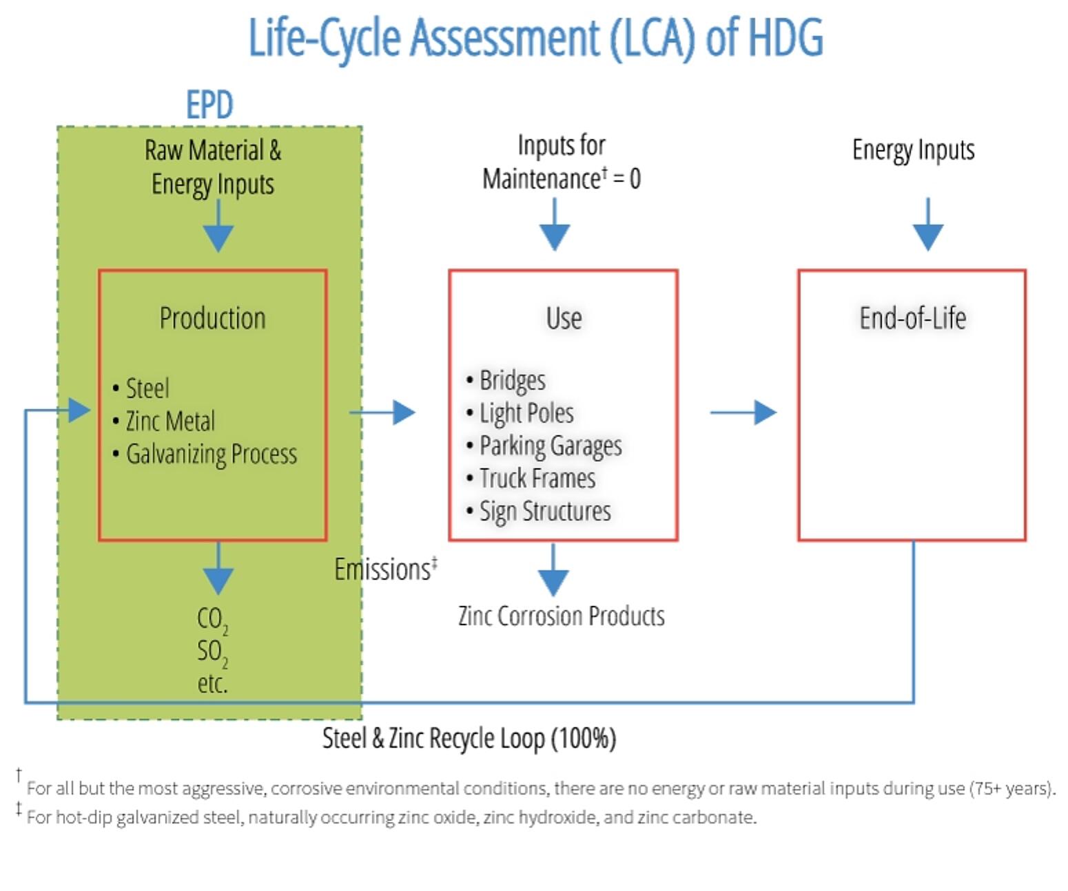

Life-Cycle Assessment (LCA)
A life-cycle assessment (LCA) is an objective measurement of a product's environmental impact. Often called a "cradle-to-grave" study, LCA quantifies the environmental impact of a process or product from raw material acquisition, energy inputs and emission outputs during production and use, and end-of-life management recycling/disposal). LCAs have begun to gain favor in the specification community as a means of gauging a product's sustainability.
Lca Chart 2016 English Epd
In 2008, the International Zinc Association (IZA) hired internationally renowned LCA experts Five Winds International and PE International to conduct a life-cycle inventory (LCI) and life-cycle assessment (LCA) for hot-dip galvanized steel. Utilizing data from worldwide sources regarding energy consumption and air/fluid/solid emissions measured during zinc production and during the actual galvanizing process, combined with analogous survey data collected from the steel industry, an LCA for hot-dip galvanized steel was compiled. This study provided a baseline understanding of the industry's impact today, one the AGA is committed to improving in the future.
In 2014, the American Galvanizers Association (AGA) began working with thinkstep, Inc. (formerly PE International) to update the LCA and generate an Environmental Product Declaration (EPD) for hot-dip galvanized steel. The EPD, which is a cradle-to-gate analysis, was then verified and published by UL Environment in 2016, following the principles, requirements, and guidelines in ISO 14040/14044 standards.

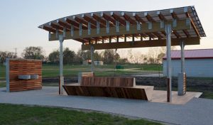

ISU Pavilion Project
Iowa State University Pavilion
Hot-dip galvanizing is unique in that all material and energy inputs and emission outputs are isolated to the production phase. HDG requires no maintenance during the practical service life of most structures, i.e. 75 years or more. This means no transportation of labor to the repair site, no energy, no emissions such as sand from blasting or paint dust during removal, and no materials are needed after the initial production and installation of the HDG steel.
