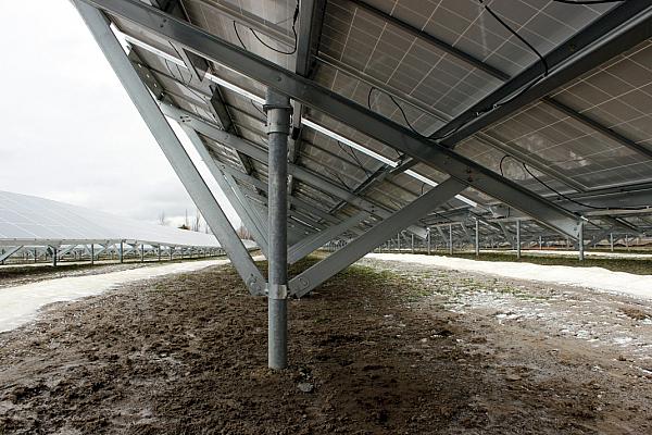

Galvanized steel in soil
After the evaluation of the soil and the galvanized coatings, probability functions were used to predict the time to first perforation of the wall of the 16 gauge galvanized corrugated steel pipe. Based on previous work by Richard Stratfull of the California Department of Transportation, the predicted service life of 16 gauge corrugated steel pipe will be twice the number of years to first perforation. Therefore, the model and analysis developed by Corrpro conservatively estimate the service life of corrugated steel pipes in soil applications to be time to first perforation plus 50%.
Using the same data and statistical model developed by this study. The AGA modified the service life equation to be more appropriate for structural steel elements buried in soil. For structural galvanized articles, the service life is defined as total zinc coating consumption, plus 25% (so 75% of the base steel integrity is present at the end of the life).
