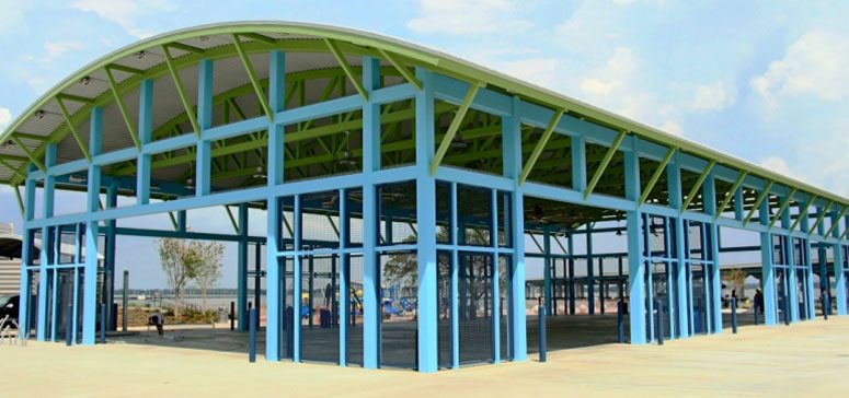

Painted Galvanized Steel Example - Biloxi Waterfront Pavilion 14
For years, protecting steel from corrosion typically involved either the use of hot-dip galvanizing or some type of paint or powder coating system. However, more and more corrosion specialists are utilizing both methods of corrosion protection in what is commonly referred to as a duplex system - simply painting or powder coating steel that has been hot-dip galvanized after fabrication.
The synergistic effect of using two coatings extends the service life for unparalleled corrosion protection, while the metallurgically-bonded galvanized coating serves as an ideal primer to provide an impervious barrier for the base steel. When paint and galvanized steel are used together, the corrosion protection is superior to either protection system used alone and can last from 1.5 to 2.3 times the combined lifetimes of both systems. In other words, if you had a paint system that lasts 10 years and a hot-dip galvanized system expected to last 70 years, the duplex system would last 120 - 200 years; if you just let the paint and galvanizing wear away naturally.

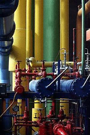

Painted pipes
The key to successfully painting hot-dip galvanized steel is surface preparation.

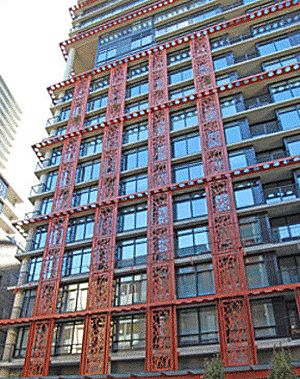

Woodwards building duplex coating
Powder Coating over hot-dip galvanized steel to protect its exposed decorative steel elements from corrosion without detracting from the buildingâs aesthetics.
Powder Coating Galvanized Steel
Powder coatings on hot-dip galvanized steel provide an excellent corrosion resistant coating. The selection of this duplex system has two major attractions; the duplex system provides a high-grade architectural finish that does not contain any volatile material and the coating is particularly abrasion resistant.The powder coating is comprised of a polyester thermosetting resin that is applied to a clean galvanized surface and cured at temperatures near 350 F (180 C).  The specification ASTM D7803 has been established to detail the best practice for preparing hot-dip galvanizing for powder coating.  Proper surface preparation is critical to ensure a successful duplex system of galvanizing and powder coating.
