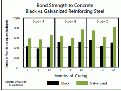

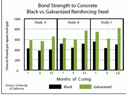

Three studies looked at the bond strength of hot-dip galvanized rebar compared to black rebar: Zinc Coated Reinforcement for Concrete, The Influence of Steel Galvanization on Rebars Behavior in Concrete, and Bond of Ribbed Galvanized Reinforcing Steel in Concrete. In each of these studies, researchers found hot-dip galvanized rebar had the higher bond strength to concrete than black rebar. Figure 1 shows the various bond strengths observed for hot-dip galvanized rebar and black rebar in different studies. The increase in bond strength offered by the hot-dip galvanized coating is believed to be caused by calcium hydroxyzincate crystals, which develop between the galvanized coating and the concrete. The crystals increase the adhesion of the galvanized rebar to the concrete and thereby increase the bond strength.
