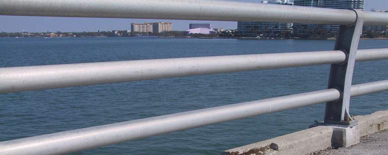

A less common environment for galvanized steel is submerged in or exposed to water. Moisture is highly corrosive to most metals including steel and zinc. Despite the difficulty of predicting corrosion, hot-dip galvanizing steel is one of the best methods of corrosion protection for submersed applications because of its complete, uniform coverage. Similar to the zinc patina in atmospheric exposure, some waters allow the zinc coating to develop a passive film on the surface slowing the corrosion rate. For coastal and marine structures, galvanized steel alone often performs well below the splash and tidal zones; in severe splash zones, consider duplex systems for added protection.

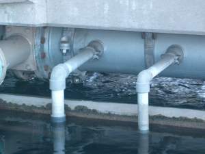

Galvanizing is successfully used to protect steel in freshwater exposure. Freshwater refers to all forms of water except sea water. Freshwater may be classified according to its origin or application. Included are hot and cold domestic, industrial, river, lake and canal waters. Corrosion of zinc in fresh water is a complex process controlled largely by impurities in the water. Even rain water contains oxygen, nitrogen, carbon dioxide and other dissolved gases, in addition to dust and smoke particles.
Groundwater carries micro-organisms, eroded soil, decaying vegetation, dissolved salts of calcium, magnesium, iron, and manganese, and suspended colloidal matter. All of these substances and other factors such as pH, temperature, and motion affect the structure and composition of the corrosion products formed on the exposed zinc surface.
Relatively small differences in freshwater content or conditions can produce relatively substantial changes in corrosion products and rate. Thus, there is no simple rule governing the corrosion rate of zinc in fresh water. However, one trend data supports is hard water is much less corrosive than soft water. Under conditions of moderate or high water hardness, a natural scale of insoluble salts tends to form on the galvanized surface. These combine with zinc to form a protective barrier of calcium carbonate and basic zinc carbonate which slow the corrosion rate.

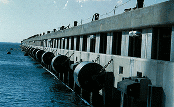

Galvanized coatings provide considerable protection to steel immersed in seawater and exposed to salt spray. The factors that influence the corrosion of zinc in fresh water also apply to sea water. However, the biggest determinants to galvanized steels performance in seawater are temperature and ion interaction.
Pier replacements
  • Temperature: Seawater temperature varies widely from 28.4 F at the poles to 95 F near the equator. For all waters, the warmer the water, the higher the attack on zinc because reactions between oxygen and zinc happen faster at higher temperatures. This is why tropical seawater is much more corrosive than temperate seawater. Temperate seawaters have a freeze cycle and are often less corrosive to galvanized steel than even fresh soft waters.
  • Ion Interaction: In moderate temperature ranges zinc forms salts with magnesium and calcium that are not water soluble. These passive compounds form on the surface preventing the zinc metal from reacting with oxygen and chlorides which slows the corrosion rate. Tropical waters tend to stay at 70 or above, making it difficult to develop these compounds, as the colder the temperature the better the formation.
Given the high level of chloride in sea water, a very high rate of zinc corrosion might be expected. However, the presence of magnesium and calcium ions in seawater has a strong inhibiting effect on zinc corrosion in this type of environment. Results from accelerated laboratory tests sometimes use a simple sodium chloride (NaCl) solution to simulate the effects of seawater exposure on galvanized steel and should be viewed skeptically. Real world results often differ significantly from accelerated laboratory tests.

One of the most corrosive areas for galvanized steel is on wash zones and tide lines. The agitation accelerates the corrosion rate of the zinc. Often the washing motion removes the passive scales which are forming on the surfaces, exposing fresh zinc which tries to redevelop more scales/patina. This leads to rapid erosion of the zinc coating resulting in increased corrosion rates. For critical structures in severe splash or tidal zones, a duplex system (paint or powder coating over hot-dip galvanizing) is typically recommended to extend service life beyond galvanized steel alone.
