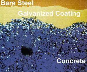

Galv Rebar Element Map300
Elemental map of galvanized rebar. The corrosion products of galvanized rebar are less dense and do not build up the pressure to cause concrete spalling (unlike the dense corrosion products of bare steel). The zinc corrosion products (depicted below, in white), migrate away from the galvanized coating and disperse into the concrete matrix.
The final and, perhaps, most remarkable phenomena contributing to the superior performance of galvanized rebar deals with the actual corrosion products of the zinc coating itself. Cracking—or, in its most severe form, spalling—occurs as a result of a local increase in internal pressure due to volume increase when metal transforms into corrosion products. As steel corrodes, the voluminous products formed as part of the corrosion reaction need some place to go and pressure builds until a crack in the concrete matrix results. Continued corrosion results in the production of more corrosion products, further cracking the concrete and spalling until the article is no longer fit for service. The corrosion of zinc coated rebar occurs in a slightly different fashion. Zinc corrosion products are very small and migrate away from the surface of the rebar and into the bulk media of the concrete matrix. This can be seen in the figure, right,
This phenomenon results in a small increase in internal pressure at a much slower rate. Ultimately, this translates into a longer service life for galvanized rebar.
