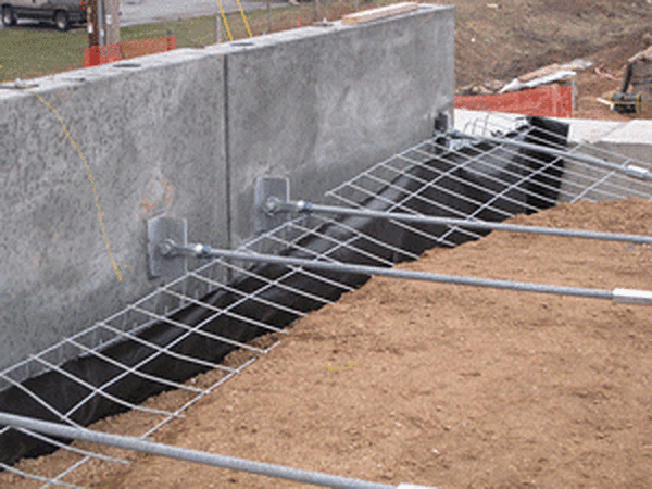

Another common exposure for hot-dip galvanized steel is partially or fully buried in soil. The zinc coating delays the onset of base-steel corrosion, proving a reliable and cost-effective way to reduce corrosion risk with little maintenance. This is supported by the many well-established and proven uses of galvanized steel in soil-contact applications, including reinforced earth, buried steel bridges, buried utility poles, ground-mounted solar structures, buried guardrail posts, bridge piling, and retaining walls. Coating life is directly related to zinc thickness: when other conditions are equal, a thicker zinc coating provides a longer period of protection.

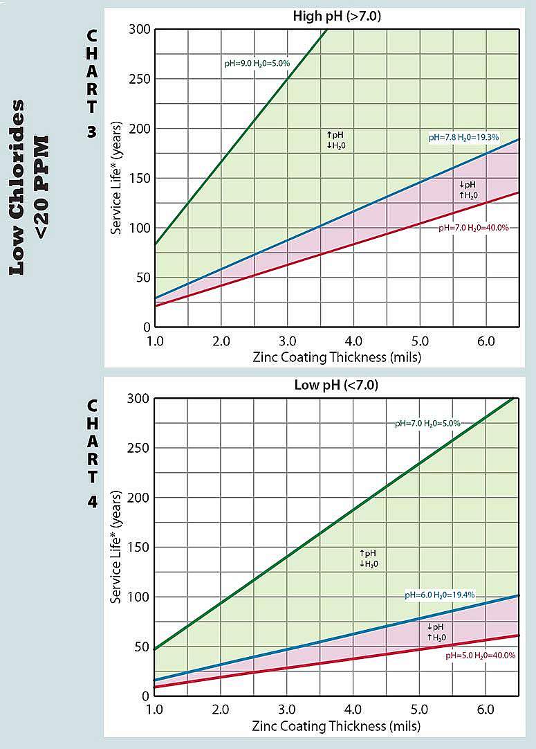

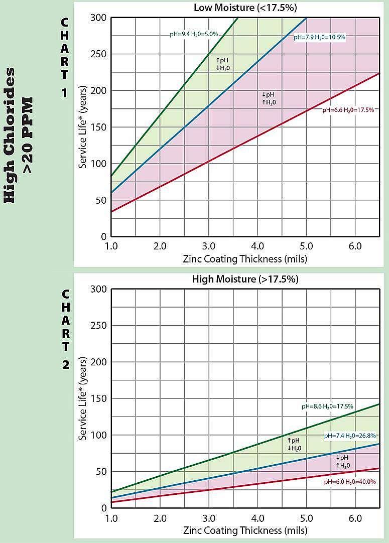

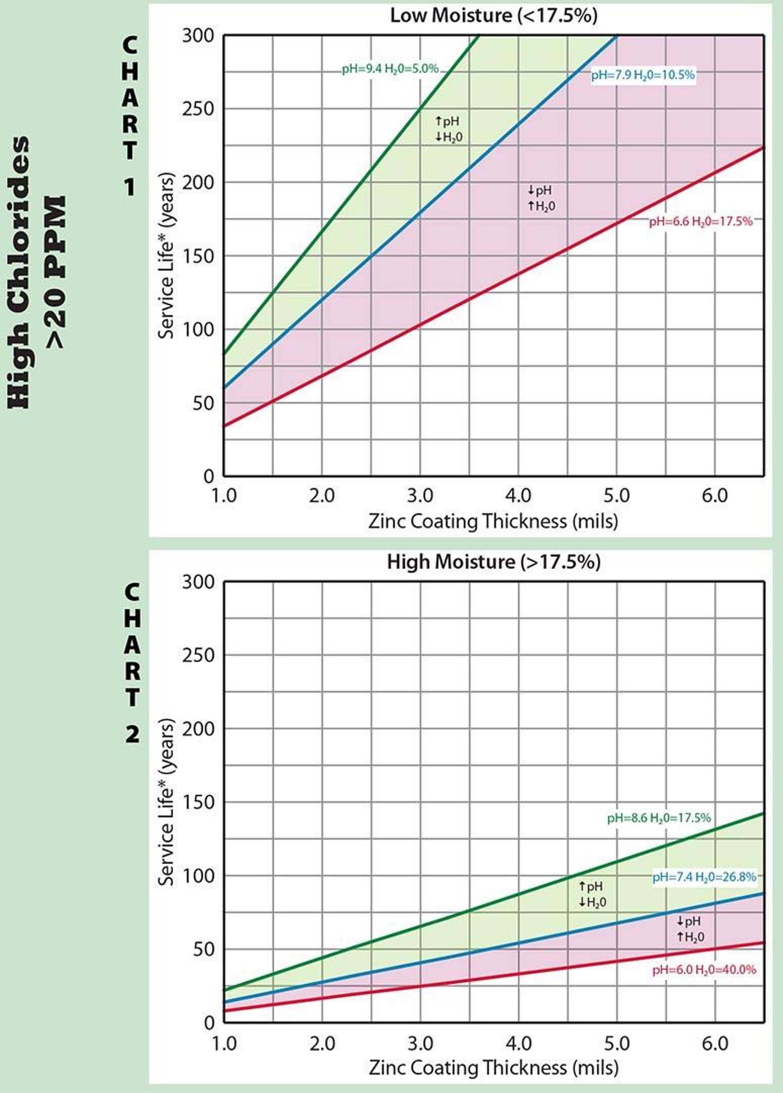

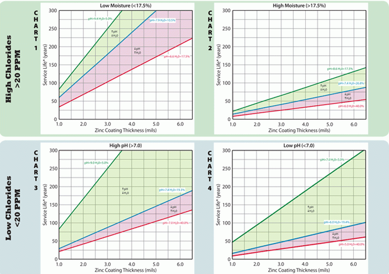

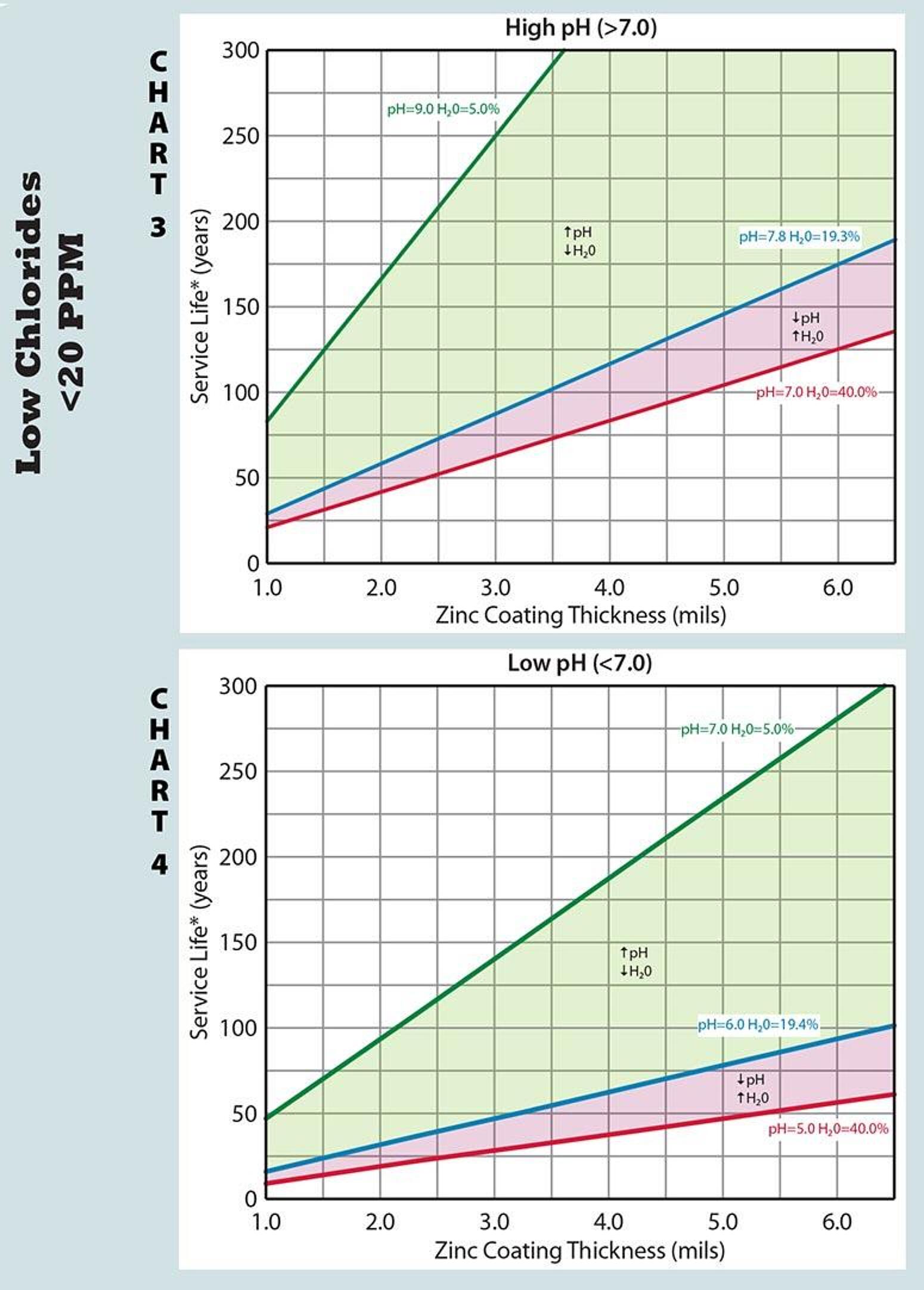

As soil changes even over a short area, and the corrosivity of the soil can vary greatly, misclassifying the soil can lead to unpredicted performance. The AGA has developed a chart for estimating HDGs performance in natural soils based on real world corrosion data. In this case, service life is defined as total consumption of the coating.
The blue line on all four charts represents the average for soils surveyed in that characteristic group. The green line represents the best soil in the category sampled, and the red line represents the worst soil in the category from the study. The shaded areas show how the changes in pH and moisture content affect the estimated service life. Assuming 3.5 mils as a minimum thickness for HDG buried in soil, the chart shows the average life in the harshest soils (uncommon) would be approximately 30 years and in the best soils exceed 120 years.
