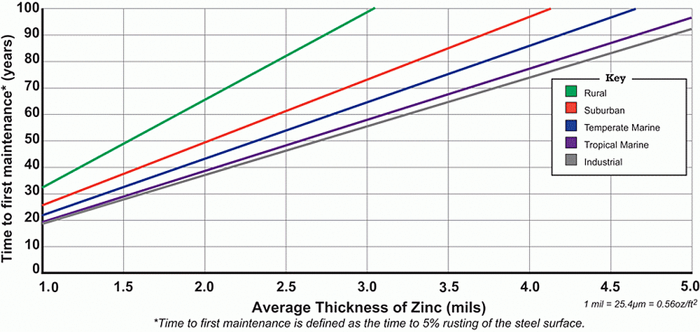

Since the 1920s, hot-dip galvanized steel samples have been placed in thousands of different environments and the corrosion rate has been measured. Five environments are generally recognized (rural, urban, industrial, temperate marine, and tropical marine) and the corrosion rate in each has been plotted on a graph to provide an estimated durability for hot-dip galvanized steel.

To assist in predicting the life of hot-dip galvanized coatings in atmospheric environments, the AGA Time to First Maintenance Charts can be used. For soil environments, consult the Service Life of Galvanized Steel Articles in Soil Applications chart. If the corrosion rate and time to first maintenance for a specific project site is desired, a more accurate estimate may be obtained by inputting data such as average precipitation, average salinity, and average sulfur dioxide for the local area around the project site into an online model called the Zinc Coating Life Predictor.
