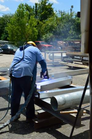

To assist in this evaluation, a study was conducted to evaluate thirteen repair materials and twenty application methods for the repair of hot-dip galvanized coatings. Each repair material was evaluated in terms of ease of application, aesthetics, adhesion, abrasion resistance, and corrosion resistance. The following table summarizes results from the study in addition to practical experience from the hot-dip galvanizing industry:
| Repair Material | Advantages | Disadvantages |
| Zinc-Based Solder | - Affordable - Easy to apply - Good barrier protection - Good cathodic protection - Very good adhesion - Best color match to HDG | - Difficult to apply on curved, vertical, and overhead surfaces - Difficult to apply over large surface areas - Thin coatings tend to be produced - Low abrasion resistance - Requires heat source |
| Zinc-Rich Paint (organic & inorganic formulations) | - Easiest to apply - Lowest cost - No limit to coverage area - Brush-on application facilitates achieving minimum thickness - Various shades available to assist in appearance matching - Very good barrier protection - Very good adhesion | - Lower cathodic protection than other two methods - Low abrasion resistance - Potential for poor appearance match - Spray application results in thin coatings requiring multiple applications - Depending on weather/location, inorganic zinc rich formulations may require control of relative humidity and temperature during application |

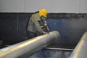

| Zinc-Spray (Metallizing) | - No limit in coverage area - Very good barrier protection - Excellent cathodic protection - Very good adhesion - Good abrasion resistance - Good appearance match | - Most expensive - Extensive equipment and qualified personnel required for blasting and application - Difficult to apply on internal surfaces or hidden corners, recesses, holes - Quality of repair highly depends on experience and qualification of applicator |
