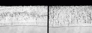

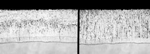

ASTM A123 acknowledges that silicon, phosphorus, and carbon content in steel affect the galvanized coating. ASTM A385 recommends limits and ranges for steel chemistry to ensure a high quality galvanized coating. The galvanized coating of steel with the recommended chemistry - non-reactive steel - will have a coating similar to the magnified coating in Figure 1. This coating has four distinct layers. The gamma, delta, and zeta layers are intermetallic alloy layers, and are harder than the base steel. The alloy layers give galvanized steel its outstanding abrasion resistance. The eta layer is the same composition as the zinc in the galvanizing kettle. The eta layer is responsible for the bright shiny appearance. Steel with chemistry outside the recommended limits and ranges for galvanizing is known as reactive steel.
A micrograph of a galvanized coating on reactive steel is shown in Figure 2. This coating has a very thin eta layer, although some reactive steels have no free zinc layer. Reactive steel has intermetallic alloy layers in the same order as non-reactive steel. However, the zeta layer in reactive steel is overgrown and tends to compose most of the galvanized coating thickness. Intermetallic layers do not have a bright shiny finish, and when exposed, appear dull gray. Galvanized coatings on reactive steels can be much thicker (over 10 mils) than coatings on non-reactive steel. The galvanized coating is created through a metallurgical reaction between iron in the steel and zinc in the galvanizing kettle.

Figure 1 (left) and Figure 2 (right)

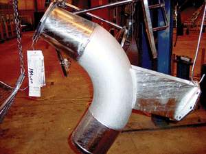

This means faster withdrawal rates can create thicker coatings. Non-reactive steel completes its reaction with zinc after a few minutes in the kettle. However, reactive steel continues reacting as long as there is free zinc available and the temperature is high enough (greater than 500F) ? even when outside the galvanizing bath. This happens when reactive steel on thick, heavy parts is cooled slowly. If reactive steel consumes the entire eta layer, the zeta intermetallic layer will grow to the surface and will transform the part from shiny to dull as the part cools. When the steel is dipped into a quench tank immediately after galvanizing, the temperature of the steel drops several hundred degrees quickly; thus stopping the metallurgical reaction. Quench options include water, chromate and phosphate. Service life of the galvanized coating cannot be estimated from the appearance of the galvanized coating; it must be measured with a coating thickness gauge. The corrosion protection a galvanized coating offers is directly proportional to its thickness ? the thicker the coating, the greater the corrosion protection.
This means a dull gray coating that is thicker than a bright shiny coating will offer a longer service life. There are several ways to improve the brightness of galvanized coatings. The most important is to choose steel with chemistry within the recommended limits and ranges for silicon, phosphorus and carbon. If this is not possible, reactive steel can be blasted before galvanizing to roughen the steel surface. Roughening the steel surface creates peaks and valleys. These peaks and valleys interfere with growth of the zeta intermetallic layer because it grows in long columns toward the surface coating. Limiting submersion time in the kettle and using lower kettle temperatures will also help to suppress intermetallic growth on reactive steel. Adding aluminum to the galvanizing kettle directly improves the brightness of galvanized coatings, and nickel indirectly brightens the coating. Decreasing cooling time by quenching will also brighten the galvanized coating by preventing consumption of the eta layer.
