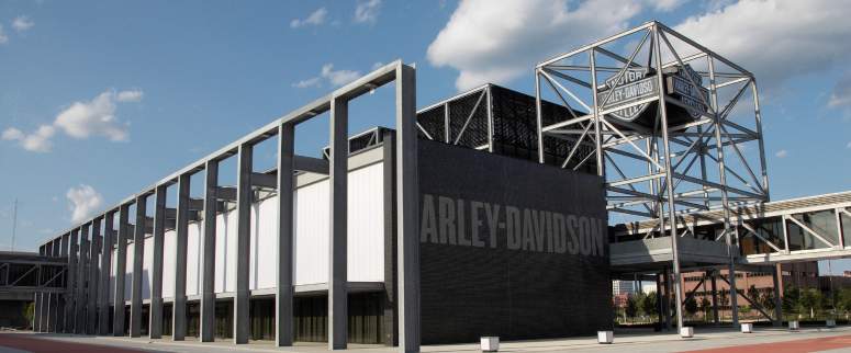

Harley Davidson Museum
The Harley Davidson Museum in Wisconsin is a great example of hot-dip galvanized steel used in an AESS design.

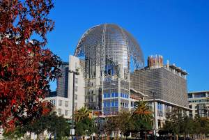

San Diego Central Library
The San Diego Library is another example of a successful galvanized AESS project.

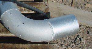

Increased Thickness In Weld Area
Figure 1: Increased Thickness in Weld Area
For example, if welds are required to be contoured and blended the fabricator can perform this before HDG, but depending on the chemistry of the weld material a thicker and/or darker HDG coating may be present over weld area after galvanizing. Therefore, additional smoothing after hot-dip galvanizing is often needed to ensure weld contouring and blending in addition to optional use of recommended welding materials or weld material with a chemical composition closer to the base steel.

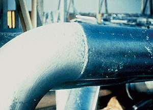

Different Steel Chemistries
Figure 3: Combining steel of different chemistries may result in mixed shiny/matte appearance.
Where unavoidable, materials can be sent to the galvanizer separately in an attempt to match appearance before bolting/welding after galvanizing or abrasive blasting before HDG can be specified to maximize the potential for a uniform appearance.

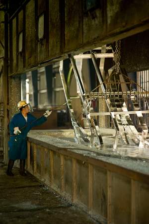

removal of an article from the molten zinc galvanizing bath

In addition to optimizing the design for hot-dip galvanizing, there are process controls the galvanizer can implement for AESS projects to minimize the amount of surface smoothing after galvanizing. Specifically, it may be possible for the galvanizer to hang parts at the highest possible angle, keep suspension of the parts above the height of the bottom dross layer, immerse the parts as quickly as possible, minimize dip time and withdraw parts slowly from the bath.
In addition, some galvanizers include elemental additions to the galvanizing bath to improve aesthetics, zinc fluidity and drainage. These process controls are not necessarily applicable or suitable for every project. For example, the aesthetic quality for steels with a chemical composition outside the recommendations for galvanizing may be negligibly affected by many of these process controls. Regardless, the ability and/or willingness of the galvanizer to perform specific optimizations should be discussed during the project bid phase.

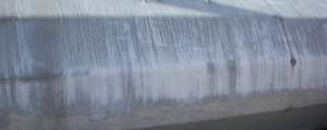

After acceptance of the material, hot-dip galvanized articles should be stored in a way to minimize the occurrence of wet storage stain.
Wet Storage Stain Example
Figure 4: Wet storage stain
The presence of light or medium wet storage stain does not negatively affect the level of corrosion protection and does not require remediation, but for aesthetic purposes it can be removed using commercially available chemicals and a stiff nylon bristle brush. Despite the presence of light or medium wet storage stain, the parts will weather to a uniform appearance over time typically six months to two years depending on the environment.
