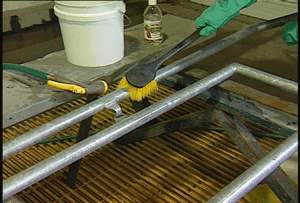

Cleaningwith Brush
Cleaning the steel surface with a brush
Cleaning
When cleaning a galvanized surface prior to painting, the goal is to remove any dirt, grease or oils. At the same time, care must be taken not to remove too much of the galvanized coating. Highly acidic or basic cleaning solutions remove some of the zinc coating, as does high-pressure sweep blasting. The more zinc that is removed from the surface, the less corrosion protection provided. Alkaline cleaning, ammonia cleaning, and solvent cleaning are the most common ways of removing dirt from a galvanized surface. As some cleaners may react differently with different paint systems, the paint manufacturer should be consulted for specific cleaning instructions.

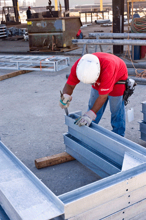

In order to provide a good adhesion profile for the paint, the galvanized surface must be flat with no protrusions and slightly roughened to provide an anchor profile for the paint system. Filing high spots, sweep blasting, phosphating, and using wash primers or acrylic passivations are the most common methods of increasing the profile of a galvanized surface. Again, care must be taken not to damage the galvanized coating.
