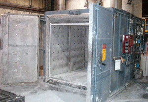

Next, pre-baking in a drying/curing oven reduces the potential for the galvanized coating to outgas. This process will aid in the expulsion of any trapped air or water in the coating as well as ensure that the surface of the steel is free from any moisture. The pre-baking should be conducted at higher temperatures than the curing oven; this temperature is typically 65 F higher than the curing oven. If the galvanized steel is run through a phosphate wash prior to powder coating, it is recommended that the pre-bake oven temperature not exceed 535 F. Higher temperatures will deteriorate the thin phosphate coating, converting it into a powdery substance that could affect adhesion. The part should be pre-baked until the galvanized surface reaches the oven temperature.  Typically, this is one hour to assure all moisture and entrapped gasses are expelled.  The part should then be cooled to a temperature that allows application of the powder coating in accordance with the manufacturer’s instructions.
Small Batch Oven
Small Batch Oven
