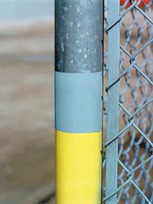

Duplex Systems combine the superior protection of galvanized steel with the additional benefits of another corrosion protection system, such as powder coating or paint, to extend the corrosion protection of a product even further. The synergistic effect of using two coatings extends the service life for unparalleled corrosion protection, while the metallurgically-bonded galvanized coating serves as an ideal primer to provide an impervious barrier for the base steel.
Chinatown Park duplex system
When paint/powder coating and galvanized steel are used together, the corrosion protection is superior to either protection system used alone and can last from 1.5 to 2.3 times the combined lifetimes of both systems. In other words, if you had a paint system that lasts 10 years and a hot-dip galvanized system expected to last 70 years, the duplex system would last 120-184 years if you just let the paint and galvanizing wear away naturally.

Proper surface preparation is crucial for achieving strong adhesion between the galvanized steel and the specified coating. While both powder coating and painting require thorough surface preparation to ensure good adhesion and long-lasting protection, there are some key differences in the steps involved.
It is important to know the initial surface condition or age of the galvanized steel that will be painted or powder coated as the age dictates the appropriate steps to prepare the HDG steel for coating application. Hot-dip galvanized steel can be divided into three categories: newly galvanized steel, partially weathered galvanized steel and fully weathered galvanized steel. Each type of galvanized steel must be prepared slightly differently because the galvanized surface has different characteristics at each stage of weathering.
