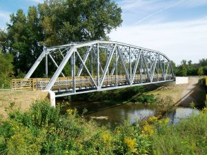

When hot-dip galvanizing older steel which has been recycled from another project, the steel can sometimes be in poor condition or badly corroded. However, as long as the steel sections are structurally sound and fit for purpose, it is possible to refurbish and hot-dip galvanize. The Knox County Bridge in Ohio (2010) is an example of a successful recycling project where painted steel was disassembled, rehabilitated, and prepared successfully for galvanizing. Although there can be substantial cost and maintenance benefits to the user when choosing to recycle and then hot-dip galvanize old steel, the galvanizer should be aware of the potential for additional surface preparation and the effect on final coating appearance.
