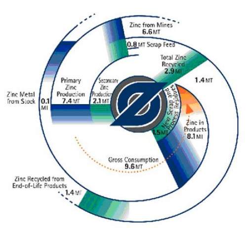

At present, approximately 70% of the zinc produced worldwide originates from mined ores and 30% from recycled or secondary zinc. The level of recycling is increasing each year, in step with progress in the technology of zinc production and zinc recycling. Today, over 80% of the zinc available for recycling is indeed recycled.
Zinc is recycled at all stages of production and use for example, from scrap that arises during the production of galvanized steel sheet, from scrap generated during manufacturing and installation processes, and from end-of-life products.
The Zinc Recycling Circuit

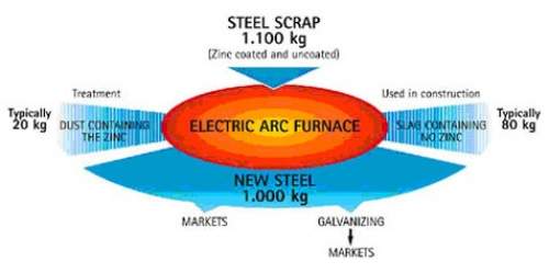

The presence of zinc coating on steel does not restrict steels recyclability and all types of zinc-coated products are recyclable2. Zinc coated steel is recycled along with other steel scrap during the steel production process the zinc volatilises and is then recovered.
Zinc coated steels are easily collected and treated in existing process streams. The Electric Arc Furnace (EAF) is the most widely used process for recycling zinc-coated steel. The high temperatures cause zinc which is volatile at high temperatures to leave the furnace along with other gases. The gas stream is treated and the zinc collected in the dust, of which zinc (18-35%) and iron are the main constituents. These dusts undergo an enrichment process in a rotary kiln, known as a Waelz kiln3. This leads to the production of zinc oxide, which in turn becomes a raw material for the production of zinc metal. Several new technologies are in use or under development for processing EAF dusts and the valuable metals they contain.
The Electric Arc Furnace Process
